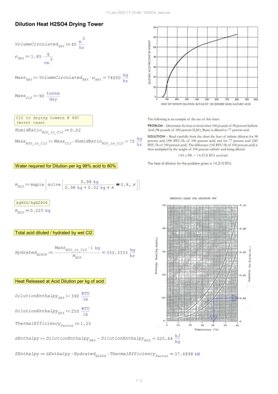

I am unable to find a suitable value for Heat of Dilution of concentrated H2SO4. I will share my calculation here as well but first I need this value to be settled.
I have x2 documents
1] 95 kJ/mol 2] 71.76 kJ/mol
Background: I am determining cooling load while drying wet Cl2 gas using circulated H2SO4 in a drying packed tower (98w.t% > 78w.t%)
Can anyone check my calculations. Especially the part where I calculated the amount of hydrated acid ..bcz this is directly linked with heat generated

Extremely thanks for the resource. BTW the last one is valid upto 10 wt% of acid & I am handling 78 - 98%
However, your literature proved highly helpful. A side observation:
p-17 of your 2nd last resource. Why the metal loss is highest b/w 80-83wt% of acid while it lowers again at below concentrations than this. Any microscopic stuff happening here?
Seems to me there might be a tradeoff between availability of the acid molecules at the surface vs. the diffusivity of the free molecules in reaching to the surface.
