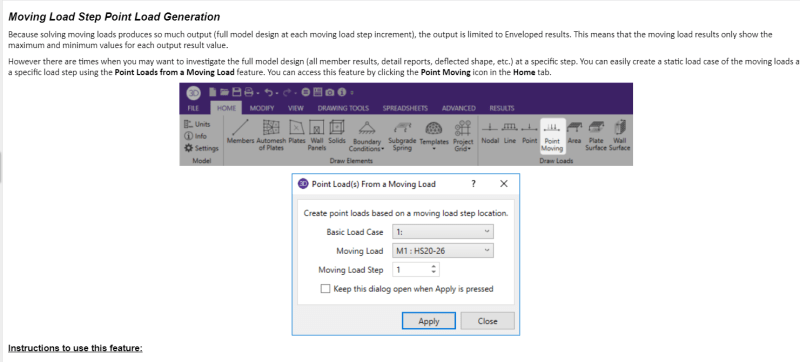

I'm waiting to hear back from RISA support, but until then...
SAY I have two moving loads in a RISA model (version 20). And I want to compare the member forces for SAY Load Step 11 of each moving load, which may not be the min/max...
Is there a way to get those results from RISA?
Is there a dump file somewhere that I could grab all of the load step results?
Thanks!
put them into separate load cases. You can combine them as well if needed.
When you're on the Home menu, there should be a "point moving" icon available to you (see image below). This allows you to convert a specific load step from your moving load into a regular basic load case. You could do this for both of your moving loads for the locations desired. But, I think that's the only way.
PS. This image is from the help file.
