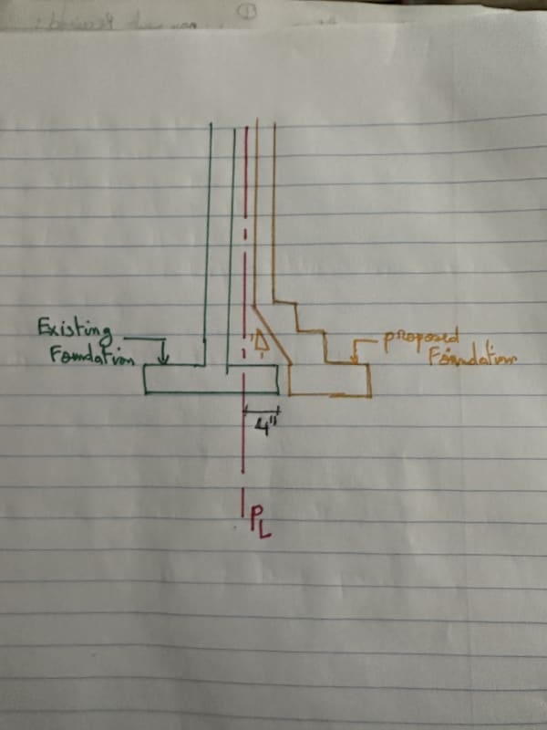

Attached, is what I'm proposing regarding the field condition with the existing and proposed footing and foundation. Anu comments?
If that sketch is accurate, I don't like it at all. I'd either get his permission to add to his footing or tell him you're going to get a lawyer and trim his footing and seek damages for trespassing.
You mentioned that the proposed basement level (slab?) is lower than the existing basement level (slab?). That is not so important. Rather, what is the difference in levels of the existing and proposed footing subgrades? The first thing I would do is talk to the adjacent owner and ask if you can trim off the 4 inch projection beyond the property line. If OK and if the new footing is not deeper than the existing, then go ahead. If the new footing is deeper than the old, that is a different problem. You may need to underpin the existing building.
Assuming the new footing is deeper and assuming reasonably average soils, no rock, and no ground water problem; underpin the existing building (with permission). Keep the front face of the underpinning even with the property line. Rear face of the underpinning should be even with the rear edge of the existing footing. Extend the underpinning straight down to at least 6 inches deeper than bottom of the proposed footing and then continue the underpinning for an additional 4 to 6 inches of depth while belling out the front face of the underpinning 4 inches beyond the property line to provide bottom bearing for the underpinning that is equal to the original footing. Trim off the front 4 inches of the existing footing that extends across the property line AFTER the underpinning is finished. Make sure the new footing is founded on well-compacted soil above the belled portion of the underpinning. No reinforcing steel is needed for the underpinning. Dry pack an approximate 2.5 to 3 inch gap between the existing footing and the top of the underpinning. If none of this makes any sense to you, call a contractor who is experienced in underpinning or call me with questions.
Thank you guys for your contributions to my post. Pham ENG (Structural), your #1 recommendation was what I was thinking after I received the Step Footing sketch, which I believe would work if the situation was a boulder, instead of footing of an adjacent existing bldg.
I'll move my footing and Foundation wall 1 foot from the Lot Line and cantilever 5" back on the first floor to meet the Lot Line. I would provide reinforced conc. piers or columns at min 6' OC and brace/tie with 4' steel beam to the columns (enough to withstand/pick up the conc. blocks wall weight and the bending moment).
