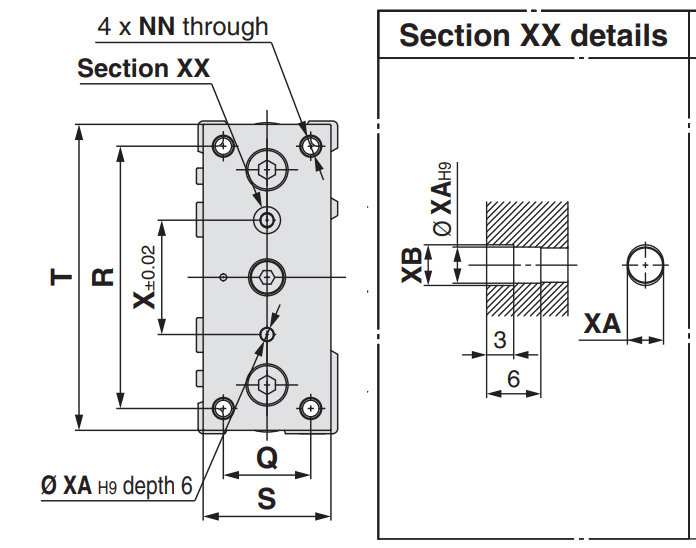

Is this an SMC pneumatic cylinder? Then check the catalog. I know, they won't include manufacturing dimensions. Why would they. But the locating pin holes (and slot-hole) are only ±0,02 so no big deal. The rest is up to you. You want a precision guided cylinder? Then position the holes with Ø0,01 or less.

I took that image from internet. So not aware of SMC cylinder.

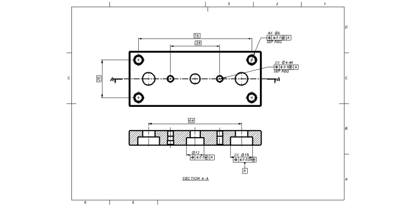

Refer below image. Is this what you are suggesting?
In this case, we are first locating middle hole.
But we need to first locate two side holes. Because those two rods are already guided within two parallel holes.
Any shift in two hole position will lead to misalignment.

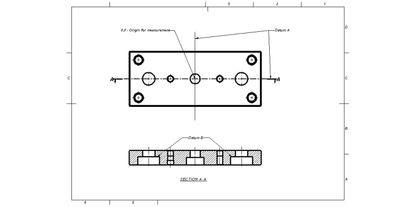

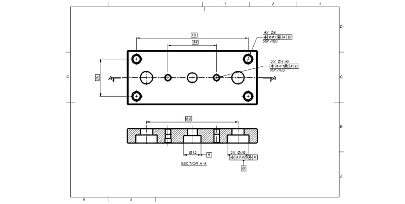

Refer below image. Is it right with our requirement?

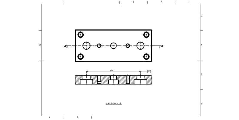

One more doubt. Shall I define location dimension as a datume. Assuming the resulting datum is a plane between two holes.
Refer below image.

Sa-Ro,
Regarding the choice between the middle counterbore (Ø12) or the two Ø15 side counterbores as the primary datum feature,
It depends on this:
Once the two Ø15 counterbores are engaged with the pair of parallel rods, is the location of the component fixed, or is it still loose and gets constrained only after the middle rod is engaged with the Ø12 rod in the middle? If the latter, then the Ø12 counterbore should be the primary datum feature for position tolerances on the other counterbores and holes, because it is the one which effectively constrains the most degrees of freedom (two translations and two rotations), in spite of being engaged in assembly second.
Absolutely do NOT attach the datum feature symbol to the dimension between holes. It is not a feature of size and such use of the symbol is meaningless.
I would go with Ø15 holes, the pattern, as primary. If Ø12 (one hole) is used primary, I think the DRF is not very stable as the hole is very shallow. (Ø15 holes are equally shallow, but at least there are two of them which drastically improves the stability)
On the same token, I would use the bottom plannar surface, maybe as secondary, to improve the stability of the tolerance zones. (some of you will think that's not a value added datum in the DRF....maybe it is for measurement....maybe not)
greenimi,
I agree that referencing one of the large flat faces as a datum feature could benefit inspection stability, but I would say it is only advantageous when used as the primary datum feature to constrain 2 rotational degrees of freedom (and one translational degree of freedom which is less meaningful in this case). In such case, I would control the secondary datum feature - which should be function-based, for a tight perpendicularity tolerance relative to the primary planar datum feature, to minimize the difference between how the part is constrained for measurement and the way it is constrained in its functional application.
Note that if the pattern of two Ø15 c'bores is used as the primary datum feature (or as the secondary after the planar face), referencing the middle Ø12 c'bore as secondary (or tertiary) is unnecessary, as it becomes redundant after the two Ø15 c'bores (or the planar face and the two Ø15 c'bores) already constrained the 5 meaningful degrees of freedom (or all 6 degrees of freedom). So this approach essentially totally eliminates the Ø12 c'bore from the datum feature selection scheme. The question is - is this the right thing in terms of function?
Using any holes of the exact part in the application as shown in the photograph as primary is a mistake.

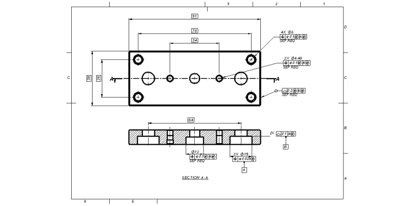

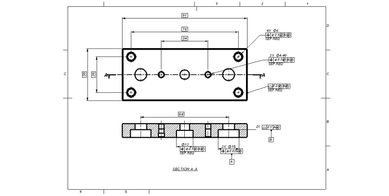

Hi
Thanks for all your feedbacks.
Finally we have concluded as below image.
Assuming the DRF as below image
Thank you.
You have datum feature B designated by a symbol, but where do you use it?
If you do want to use it, and you want to treat the flat bottoms of the c'bores as coplanar features to derive a single datum plane from, you need a coplanarity control applied to them. Your perpendicularity tolerance doesn't do that.
There are other issues too but, one a time.

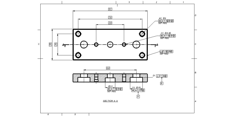

@Burunduk
Drawing updated as per your suggestion.
All around symbol added to profile of surface 0.2
