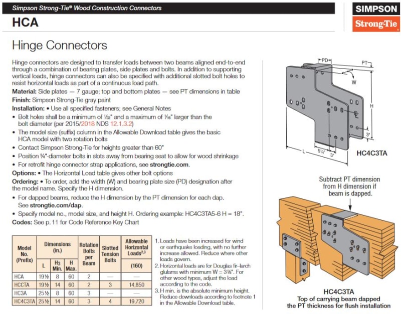

How would you feel about a connector such as this HCA from Simpson? Their diagram is a little different from mine since my beams would be the same height, but it's the same idea. With this connector the beams wouldn't need to be notched. I want to make sure that the connection doesn't end up tying the beams together in such a way that it acts like a single beam. BA's sketch shows a through bolt at the notch location. I'm not sure whether the through bolt or this HCA connector will allow the beams to move more independently.

The proposed simpson connector would also work. I'm not sure why you're saying you'd need one where the beams are the same depth. If you're cutting the beam into two spans, why not shallow up the short span accordingly for the loads? Save the homeowner some money.

Well I was thinking if I used the Simpson connector then the beams would need to be the same depth since the bottoms of the beams will need to be at the same height. I think the connectors are only for situations where the tops of the beams are at the same height. B1 bears on top of the wall top plates so I'd like B2 to also bear on the top plates at the right end of B2 where it sits on Support 3. If I go with through bolts as BA showed then I could have a shallower beam for B2.

HCA connectors are labeled hinged connectors, but if the beams are the same depth, they must be separated far enough to permit B1 to rotate at Support 2 without forcing B2 to rotate. I don't favor HCA connectors in this case.
