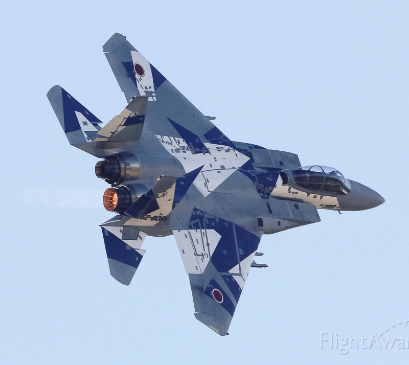

BTW... I hope everyone spots WHY this photo is VERY-disturbing to me, a former [10-Yr] F-15C/D depot liaison, and field-service, engineer?
Regards, Wil Taylor
o Trust - But Verify!
o For those who believe, no proof is required; for those who cannot believe, no proof is possible. [variation, Stuart Chase]
o Unfortunately, in science what You 'believe' is irrelevant. ["Orion", HBA forum]
o Only fools and charlatans know everything and understand everything." -Anton Chekhov
Is the F15's port engine shut down, or just an afterburner failure?
AS to the F35 accident, it looks to be accelerating downward in descent, so is maybe an engine power issue.
On the F-15 - I'd say the hack paint job. That's what happens when you use masking tape before the undercoat is completely dry.

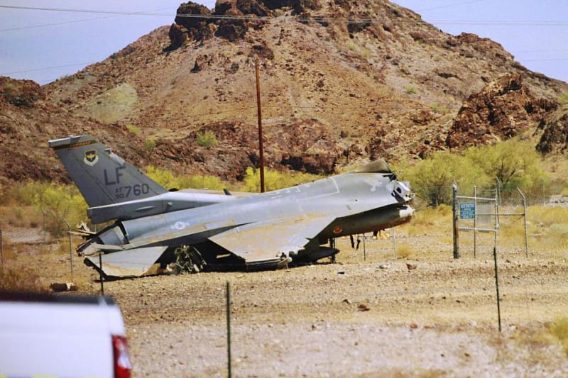

NOTE1.
Many decades ago an F-16A lost it engine over the desert. The pilot found a 'long/smooth' desert dirt road and elected to do an emergency 'dead-stick' landing on-it. At about 300-ft and 120+kts, he realized that landing on the [now visually rough] dirt road was a 'bad idea'... so he ejected, wings level at about 150-ft AGL and everything 'worked as advertised'... and he was essentially 'OK'.
YEP... the now-abandoned-jet, which was in SAS and in stabilized descent, gear-down, aligned with the road... touched-down straight-ahead on the road and eventually veered-off into the desert. The jet was upright, mostly undamaged [survivable]... and the hydrazine-powered-APU was still running [when he 'gathered-himself-up' and hiked-over to be with the jet].
HOWEVER,EVERYONE agreed that 'rolling-the-dice' to stay with the jet thru touchdown was a bad idea: ejection was the only 'right answer'. BUT, EVERYONE was impressed that the jet had so little damage and he'd done every thing he could to save it!
