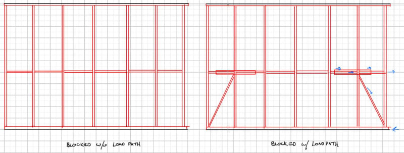

Revv - is this question specifically for CFS studs or bracing in general? Nothing special about studs. Works the same as steel columns or wood studs, really. You need a brace with sufficient strength and stiffness and a load path. The load path is the thing most people don't bother with - if you have 20 studs and just put a strap across them, you haven't done much. Sure, it'll help with point loads where one stud is loaded more than the others. But if you have a uniform load that pushes them all to the buckling load, the bracing with no load path just ensures they'll all buckle in the same direction.

to illustrate what I believe phamENG is indicating by a sufficient load path:
