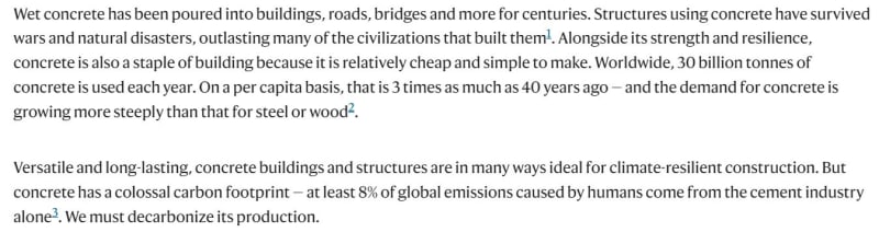

I am working with a granite company to start selling their granite as a direct competitor to precast concrete products. Since it is a natural product and the only carbon emissions are the crane to extract and the truck to transport it, it has a significantly lower carbon footprint than concrete.

dik, I know a lot has been done to use waste materials for cement, but at this point it still has to be heated to high temps which as I understand is the bigger carbon producer. From what I mentioned above, the granite product should produce the same or less carbon then just the aggregate production of concrete.
