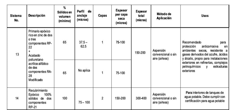

I have a question about if you have seen a table where you could check the different types of environmental and you could check what is the best system of painting for above ground painting? I remember that I saw something like this in API or ASME but I hope you could help me please with this.

System Number: 1 / Application: If the environmental is salty and humidity with temperatures of 80 Celsius / Surface preparation: Near white blast cleaning / Primer coat: Polyamine/ Intermediate coat: None / Finish coat: Polyamine epoxy 4 mils.
But I thought that was from ASME or API, maybe is from each painting company or maybe as you said company standards.

You can refer to ISO 12944-5, protective paint systems. It has Tables listing various types of primers, paints and coating thicknesses for varying degrees of corrosion and environment protection.

Thanks to everyone, I found an image in Spanish that I used to use in Mexico in my old work, but I would like to found something in English.
