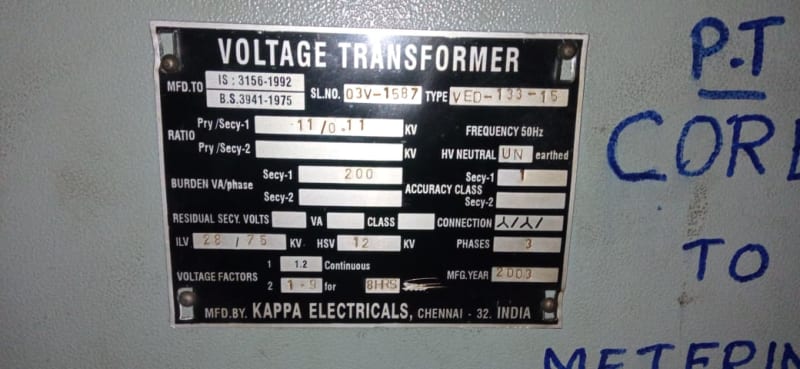

External changes : replaced original 11 kV switchgear with new 11 kV switchgear, which means replaced original VT with new VT. I suspect that the 11 kV VT is used for power supply into the magnetic amplifier and the new VT cannot supply enough VA as it wasn't thought of when the new switchgear was ordered. Hence my question about what the DC Generator/ Exciter nameplate data means.
I believe that the black box AVR is a magnetic amplifier unit, but as yet unproven.
Unless the black box is potted or welded shut, it should be a simple matter to remove a cover and have a look within, no? At the same time you can also confirm Schrödinger's cat isn't in there [groan].
There's a reason why like-for-like replacements are like-for-like . . . perhaps try a VT of appropriate rating and see what happens, or perhaps do some burden tests to confirm or exclude if what you suspect to be the case actually is.

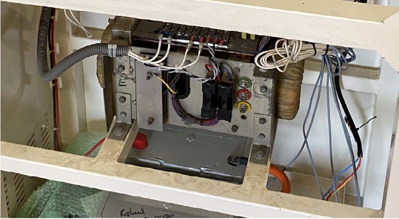

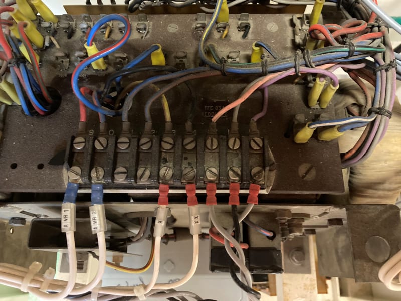

attached image of my AVR which I am assuming is a magnetic amplifier. No data, drawings next to useless, no useful nameplate on this unit. I see winding sticking out the ends and this makes me think, magnetic amplifier. Looks like a toroid style than reactor units, but these were around, I understand.
and the terminals

Nominal 82V and 4A was common on several Newage Stamford generator ends for many years, older AVR's on those units were replaced with the current AS440 regulator. Avk (before being bought by Stamford/Cummins) also used 82VDC nominal voltage regulation, but usually at 6-8 amps, at least on the units have dealt with.
If you could post some additional pictures of the AVR connections and the drawings you have it may get you some more help. You don't have to appear to have much experience in generators and their AVR's, so what's on the available drawings may not make sense to you, but several folks on this forum have quite a bit of generator experience and may find something in that documentation that provides some insight.
Your AVR looks similar some older Brush AVR's for SE (Static Excited) generators that had an integrated series boost module, but without nameplate data or more info is hard to tell if that's the case.
Hope that helps, MikeL.

Hi Catserveng. The problem is not being unfamiliar with generator and diesel gensets, the problem is I have not worked with anything this old. First time seeing a magnetic amplifier, never saw one before this job, assuming that is what it is.
I have people telling me that there's an amplidyne powering this unit - there isn't. People reading a CT nameplate and buying VT interfaces based on that; no, that's the data for the CT. That caused a lot of confusion.
There is nothing in the electrical drawings that is helpful to me. Nobody knows what happens inside the black box. Interesting idea that it might be static, but then it needs power externally, and as this is a black start unit, that would need something reliable. There are only small batteries around this unit, so I don't know, maybe the static could be DC powered, but this is not shown on the drawings.

the data next on this VT is incorrect. We have tested it as 11000:440 Vac (not 230 Vac as noted)

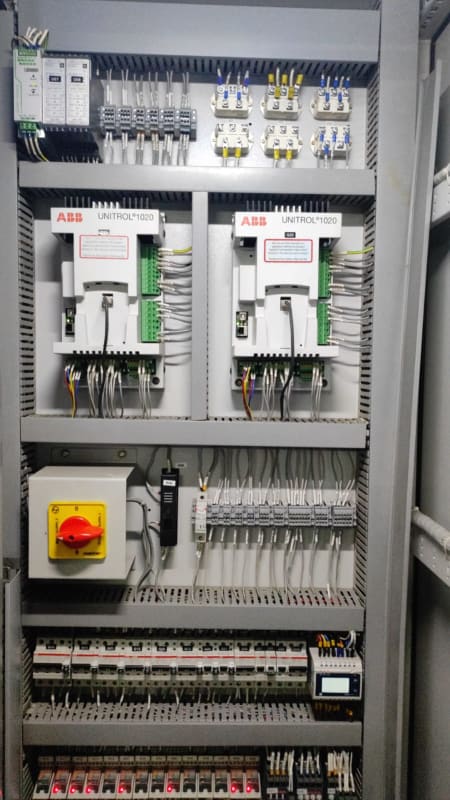

Nice photos and I see Unitrol modules, small ones. I have seen these around on other plant. The biggest one I worked with was feeding a 500MVA generator so that was a set of six panels fed by a 3.8 MVA excitation transformer. That system was quite complex while my old school 1.5 MVA unit is simple, but so far from understood that it seems much more difficult.
