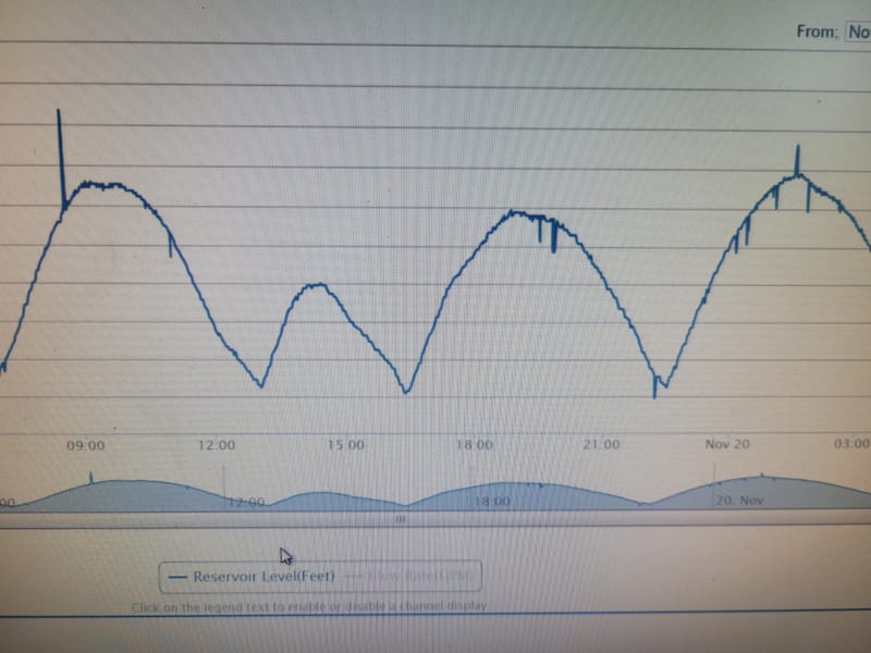

Got a problem I haven't seen before,
got these spikes in the output of a
submersible pressure transducer
These spikes occur at random times about once a day or so
This is measuring level in a water tank
Tank is 24 ft tall
The reading ignoring the spikes is cycling between 18 and 20 ft as expected
Range of the transducer is 0 to 33 ft
Any Ideas?

Spikes would not be real
It is a ground level steel water tank for domestic use
350,000 gallons
The fluid is filtered water
Spike height is different value every time
Scada box transmits the reading every 2.5 minutes, the window you see is a few hours
the spikes are only there for one reading
Sensor is 10 to 15 years old, it is a chore to replace though so trying to avoid that
Other analog inputs do not show any abnormalities
Can I put a capacitor across the 250Ω reader to dampen the spikes until we can change out the sensor?

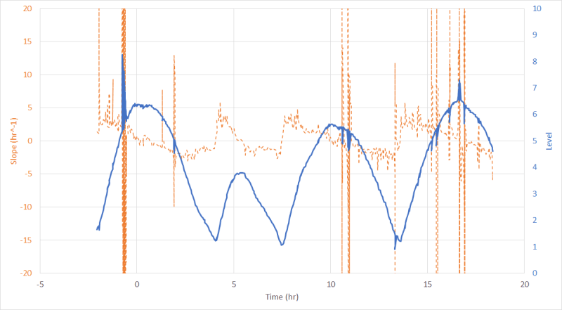

Do you use only analog data, or do you use the digital data? If the former, then possibly, but any such filter will likely clobber the real transients, such as the putative drain/refill "V" features shown in your data. If the latter, there are lots of digital filters that can remove spikes; a simple median filter or clipping function would wipe the spike.

Yes it is a 2 wire loop powered device, there are no motors in the area or any other
source of noise, it is a tank on top of a hill, there is a farmhouse nearby but no heavy machinery. the times of the spike appear to be random. I do not have a tight correlation on the source being wind in the area but it is windy now and it is more often now. There is no outside influence that I can see other than possibly wind, which points toward the ground loop fault. there are also some spikes in the downward direction.
I am also inclined to believe it is a noise artifact. I will recommend to the client the cable get replaced with a twisted shielded pair cable. It might be only a twisted cable inside a PVC conduit.
It is analog signal to a analog input to a scada box that reads the analog data and sends it via cell phone text message to the servers.
The power supply is a 24vdc with crowbar and powers another analog device that does not show any abnormal behavior. The loop is +24 from power supply to sub pressure transducer to scada to 0vdc.
Thanks thebard3, since the other signal from the scada box is reasonable, I am not looking at the box at this time, though the oem is looking in the programming to suppress this alarm.
Thanks tugboat, the installation of a different type of sensor is more costly, would put another penetration in the tank. We will stick with the sub pressure transducers.
Here is the past 2 days of graphing.
The different top off points are a normal variation in the control that shuts the valve which is subject to velocity depression in its sensor line. (it is a bug that is lived with). The fact that the top is a curve and not a point is due to the surge reduction method used on this valve as the fill line is miles long and goes through several pressure reduction valves along the way.
Do you want to remove all the spikes, or only the really large ones? Below shows the level and 3-point limnar regression slopes, so looks like ± 10 hr^-1 slope passband would eliminate most of the spikes, even some of the smaller ones. Your second image implies that it's the sensor just glitching
