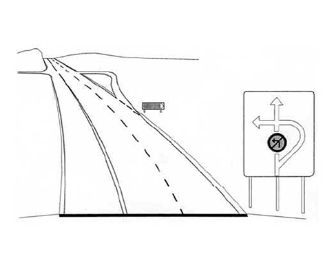

2+1 Highway 1
I'm sure there are lots of references, but here's one that has linked references
The broken link can be found here which recommends(?) passing lanes, which are very common in the US. My personal experience is that slow drivers tend not to move over like they're supposed to, so platooning doesn't always get reduced.
TTFN (ta ta for now)
The jughandle left should be familiar to anyone that has driven in New Jersey, but might take some acclimatization for everyone else.
My glass has a v/c ratio of 0.5
Maybe the tyranny of Murphy is the penalty for hubris. -
I find it interesting they say they are the first in North America, but I believe California and other places in the U.S. have them. Maybe they meant Canada? A quick search tells me California State Route 1 is like this in places.

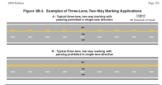

Three lane highways existed in 1963 I encountered one as part of US 1 in Maine (we were sightseeing the 1963 eclipse), I was far to young to drive. All lanes were marked with white dashes (1+1+1 ?).
The current practice, striping as 2 + 1 is hugely better.
2009 MUTCD with Revisions 1, 2, and 3 incorporated, dated July 2022
mutcd said:
On two-way roadways with three through lanes for moving motor vehicle traffic, two lanes should be
designated for traffic in one direction by using one- or two-direction no-passing zone markings as shown in Figure 3B-3.
