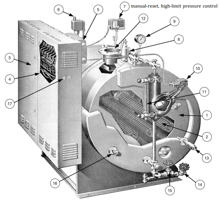

Hello all,
I have a question regarding the requirement for high-limit pressure control in ASME Section I Power Boiler.
Where does this requirement come from?
What exactly needed?
Any information and reference will be great.

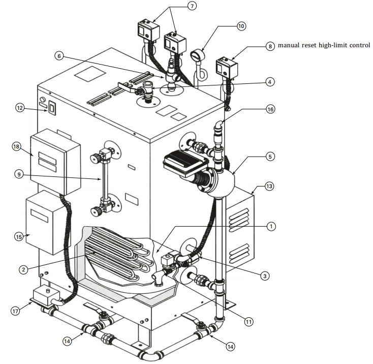

As far as I see, the code (ASME I) does not contain specific requirement for "manual reset, high-limit pressure control" as shown in ASME VII (which is only "Recommended Guidelines" , Figure 301.2-3 and 301.2-1 for example.
So, I wanted to know if there is any specific requirement for a "manual reset, high-limit pressure control" element in Electric power boilers which design and stamped per ASME I.

I was involved with limit controls for furnaces and ovens and it was the National Fire Protection Agency's NFPA 86 standard that covered control interlock requirements and used similar language.
NFPA 85 covered those topics for boilers.
The primary codes governing boiler controls are ASME CSD-1-2015, Controls & Safety Devices for Automatically Fired Boilers, and NFPA 85: Boiler and Combustion Systems Hazard Code. CSD-1 applies to boilers up to 12.5 million Btu/h. For boilers 12.5 million Btu/h and greater, NFPA-85 is the governing code.
The ASME is not a Nationally Recognized Testing Laboratory (NRTL), so they do not type certify devices like the "manual reset, high-limit pressure control" element,

As far as I see, neither CSD-1 nor NFPA 85 are referenced in ASME Section I.
Anyway, I went through CSD-1, but I couldn't find any mandatory requirement regarding a manual-reset, high-limit pressure control, but It might be a jurisdiction law, rule, or regulations which referenced to in NB-370?
Does the requirements of CSD-1 applies for the case of Electric Power Boilers up to 72kW?
If so, does the device have to be of the manual-reset type?

Indeed, it is a very sensible and important device, and there are two of which in our boilers.
One is set at 10% of the operation pressure, the high-limit device is set at 21% of the operation pressure and below the set pressure of the PRV.
The thing is, I now need to justify and approve the reason why we need two and why one is not enough.

1st device - operating pressure control is at around 10% of the required operating pressure, it stops the heating element operating.
2nd device - high-limit manual reset control is at around 21% of the operating pressure, shut down the electrical system and need a manual reset in order to be back to work.
For example - MAWP is 420kPa, operating pressure 300kPa, 1st device set to 330kPa 2nd device is at 363kPa, PRV set pressure is 400kPa.
I know that I need 2 and I know that both of them are important.
I just wanted to know
a. where is it written (in the Code (ASME I) or CSD-1 or NB-370...)
b. Does the second one need to be of the manual-reset type or not.

I very much doubt the ASME code gets this specific if you can't find it in that CSD code.
This is simply good practice and whether the second one is an ESD type manual reset to restart is up to you I feel. Some are auto resetting, but if the boiler has gone 120% over the pressure it should have been controlled at this seems like a reasonable thing to do to enforce someone to come and look at it and try and find out why.
Still don't understand why you need to justify this when it is a fixture on the boiler at the moment??
Is a few dollars that important to you? Far harder would be justifying to anyone or a court of law for anyone who gets injured why you DIDN'T include that or have REMOVED it from your previous systems. Saying "The code didn't say I had to" isn't good enough. IMHO.
