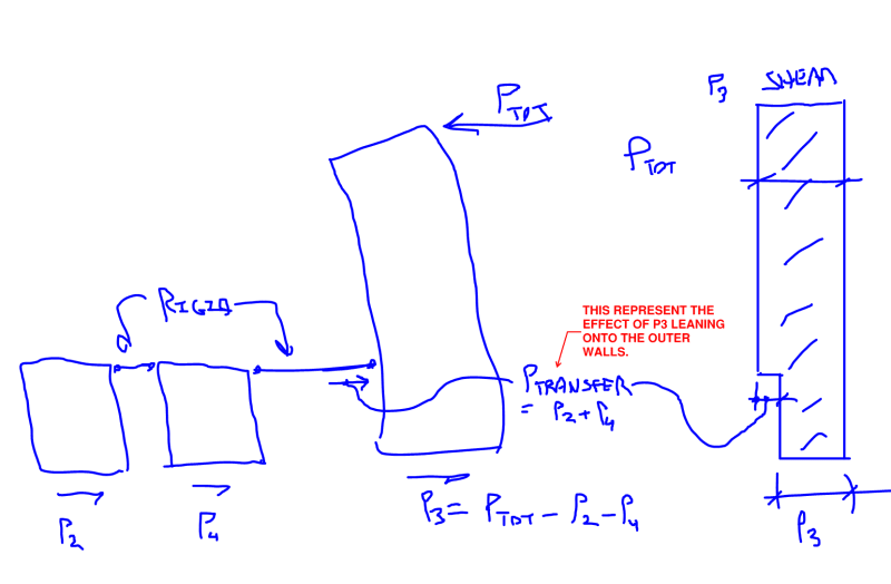

It may be useful to visualize this as a partial incarnation of the classic backstay effect described nicely in this article: Link. In this case, the backstay effect is nowhere near enough to reverse the sign of the story shear in P3 but it is enough to account for the draw down at the base level.
I've tried to illustrate this concept in the modified version of your setup shown below. Any chance that helps?
Thank you very much. That makes sense.

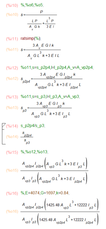

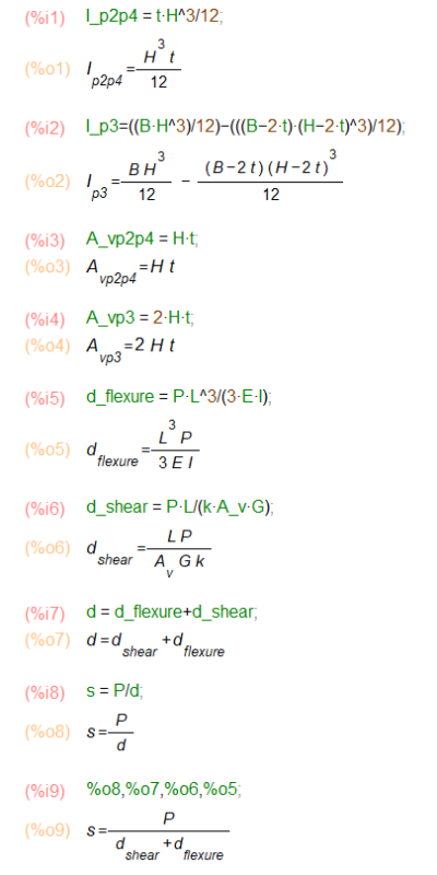

Thank you so much for your written hand calculation, very helpful.
I have a question regarding that. When you calculate the stiffness of the wall in the 1st story and 7th story, I notice that the stiffness equation becomes a function of height. Does that mean the stiffness changes as we move to another story? And connecting them to the cantilever analogy, does that mean a simple cantilever beam also has a change of stiffness along the length?
I was wondering that concept because for the flexural stiffness I see that you use "PL^3/3EI" with "L" is the height of the story.

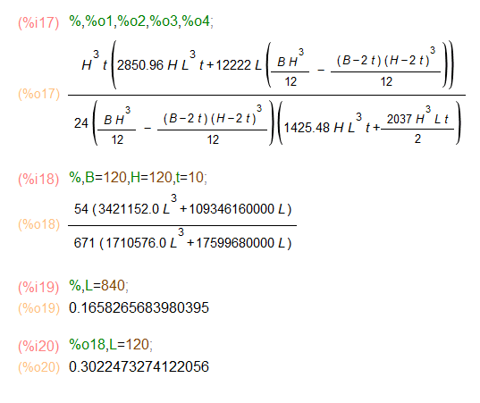

The previous calculation is a little off here is a better one that remains consistent with P3 being one entity and P2,P4 being two entities. To answer your question though yes the stiffness varies with the length (story height)
At story 7 you can see the relative stiffness of 0.16582 is nearly equivalent to the ratio of the moment of inertias which works out to 0.16095
Here are the load distribution Factors for a directly applied load:
At story 1:
At story 2:
at story 7:
