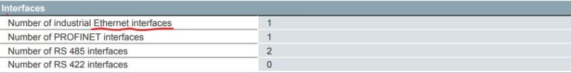

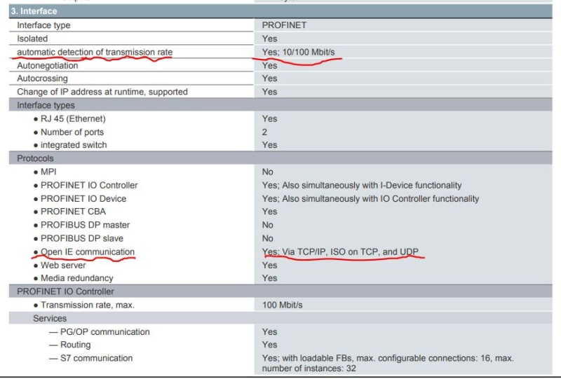

6ES7318-3FL01-0AB0 has one ethernet connection and it can be used either as ProfiNet bus or just a Industrial Ethernet connection.
Maybe not so clear in the documentation.
If your CPUs are using the Ethernet as ProfiNet you will need a additional CP343-1 if you want a Ethernet connection.

Thank you redsnake. For your clarification.
And valuable input
