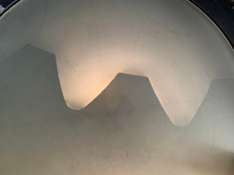

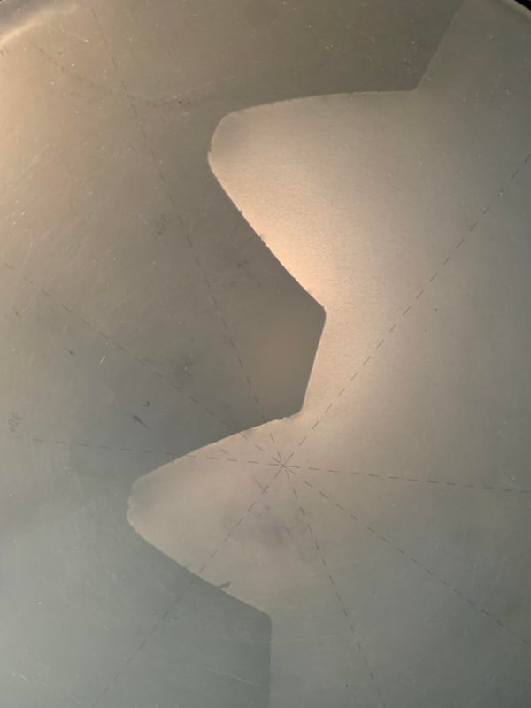

I have deducted years ago the plating in tenths in the from circular to perpendicular made no difference, the error was negligible attached is a drawing of the actual spline with minor tip and minor dia, errors.
but the involute is correct. one can now easily graphicly depict the geometry in cad. it is much easier to under stand that way. I never had an inspection issue. just remember the plate at the addendum will be much thicker than at the dedendum. it's not exact science. because of the plating dynamics.
 https://files.engineering.com/getfile.aspx?folder=8680e05e-7412-43ee-97c2-65f6cc3da530&file=27t.jpg
