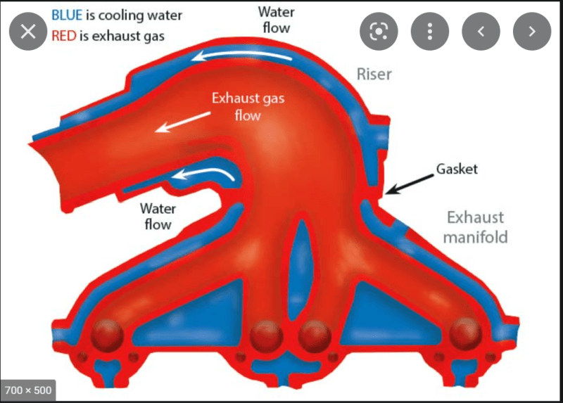

I assume you mean the seawater cooling pipework?
Stainless might last a bit longer but the warranty might be interesting to see how it works in practice.
Duplex seems a bit extreme but should work. Doesn't need the anode.
Aluminium bronze is an alternative.
LittleInch
Yes.
It is exhaust gas presumably 200-300 degrees C being immediately cooled by Seawater at about 15-22 degrees C. It is very similar to this drawing.
John Deere uses bronze for its wet manifolds. That is by far the best route. 316 stainless could work but you would need to thoroughly flush AND dry after each use.
Yes there are a lot of these in 316SS, but they must be built to fully drain with near zero retention.
The problem is simply cost.
If you want actual corrosion resistance so seawater you need Cu/Ni, NAB (Ni Al bronze), or high alloy SS (316 and 2205 don't come close).
I have seen this done for large commercial applications but not for personal craft.

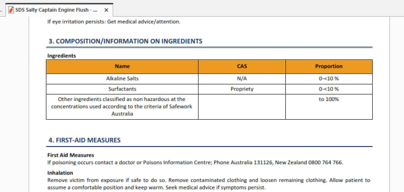

Wife bought something called a salty captain engine flush kit that is suppsoed to help with the flush. However it specifies for Outboards and PWC. No idea what the active ingredients are... But I figured its probbably helpful.
Az
Sodium nitrite makes an excellent corrosion inhibitor for flushing. It's not so good for the fishes and shouldn't be poured down drains so you would want to keep a volume of it for flushing that you can continue to recycle. It's commonly available as Diesel Engine Supplemental Coolant Additive. Mix 16:1 with water.
There is also a product called Chlor-Rid that is used for removing salt residue.
I have seen it used on industrial application where they are laying something up for storage or need to repair equipment and clean before welding.
The SDS for the Salty Captain seems to suggest possibly something like that.
Unless mistaken I think Alkaline salts could well be a sodium nitrate. I'll take a look at chlor-rid when this other thing I have runs out.
Cheers!
Don't confuse sodium nitrate with sodium nitrite.
