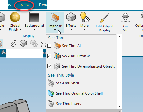

reason i say this is that there are "display modes" where you see through without any display edits.
What NX version are you running ?
Image is NX1980/ 2000
Try these options , without editing any solid bodies .

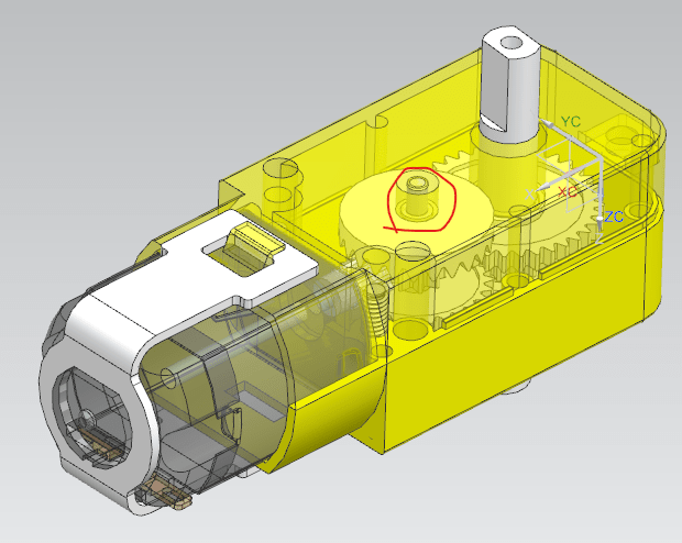

I am looking for something similar to "transparent" command in Solidworks. When you select some parts, the pop-up toolbar has an option to turn them into transparent, so that you can see the internal structure of transparent parts, other parts within them, and how they interact with each other.
Usually a section view can do similar things, but sometimes transparent works better.
I like the Translucency command in NX that I can toggle the Translucency on/off by one click, but I need to set up the translucency first, which is a bit tedius and I hope to simiplify.

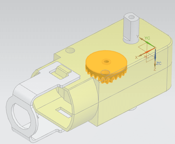

I've learned a bit about the See-Thru all. In my understanding, the selected/highlighted part will show through all other parts, but I cannot see the internal details of non-highlighted part, nor the interaction between highlighted and non-highlighted parts.
For example, here is a model I find online.
With transparent housing, I can see how the gears interact with each other. With see through all, I can only see the gear, not the shaft connecting to the housing or other details.
