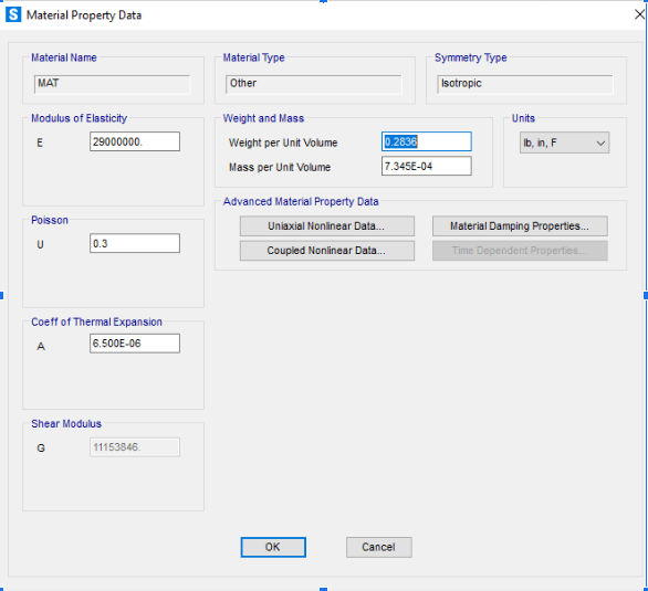

Hello,
I am trying to create a new material that does not fall under any of the materials in "Material Type." I therefore chose "Other." However, under "Other" material properties there is no spot to put the yield stress of the location. Because I want to do a crushing analysis of the model, the yield stress is important to define. Does anyone know where to define this? Could I choose one of the material types (even though it isn't correct) and just change all of the properties to match with the material. All of the defined material types have a location for yield stress. However, I feel like this may cause issues and there must be a way to add this for an "other" material.
Any help is greatly appreciated!!

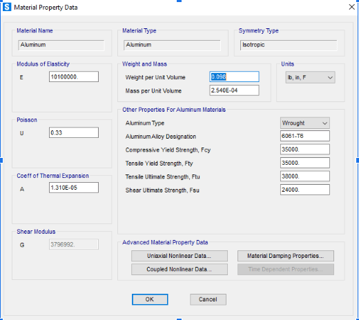

Thank you for your response. I would like to add the compressive and tensile yield strength for my material (which is a 3D printed material). However, this material doesn't fall under any of the material templates and the "Other" template does not have a spot to add yield strength. I am wondering if I can use the Aluminum material template and change all of the properties to match with the 3D printed material. I have attached two pictures, one of the "Other" material template and one of the "Aluminum" material template.

I think you need to do some learning regarding linear, and non-linear structural analysis techniques (sap can do both). Also a bit of mechanics/statics/general structural analysis.
For linear analysis, all of the material is assumed to remain elastic. That means that linear analysis does not capture buckling, crushing, tensile yield, or really any failure.
The key to linear analysis, is that the assumption is that all materials remain elastic and their section/material properties remain constant.
The results of the linear analysis can be taken from the program and compared with the material allowable stress levels manually by the user. You might find that some of the stresses inside the modeled elements are higher than the allowable stresses and this should cause a redesign or reconfiguration.
For example if you pull a spring and it snaps back to it's original location each time, the material is remaining elastic.
Sap has some built in strength checks for standard construction materials. Not for custom materials.

I can suggest that stay in the realm of linear elastic analysis. You need to only model the geometry and a few material properties to run this model. The next step is to extract the internal stresses of the elements in your model and manually compare them with the allowable stresses you have.
Stresses in the model that are well below the allowable signify elastic behavior. If the model stress is way over the allowable then its probably failure.
You should try to dial in the Modulus of elasticity of your material. This is the main material property that will effect the accuracy of the model.
Perhaps some time spent learning general Sap2000 with typical materials will go a long way for you. The modeling of this unique material is a more advanced application of sap.
