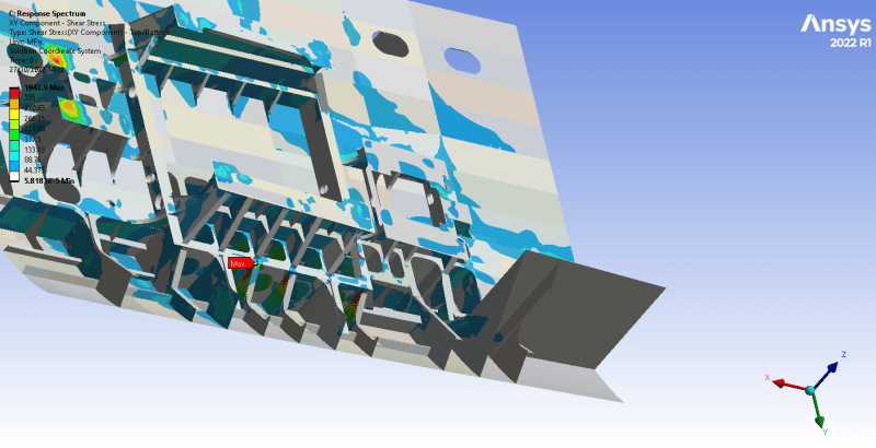

Hello,
I am a mechanical engineer with 10 years of FEA experience. I have read a lot of theory about the subject, but didnt find any book/course/tutorial,which can help us complex structures, I mean, all show how to face singularities, hourglassing, etc, but I couldnt find any course which establishes a procedure to face structures like the showing one:

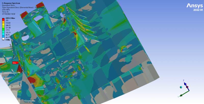

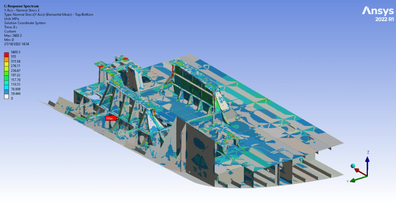

This structure, has been optimized to static environment, but the showed one, is an spectrum analysis, where the normal and shear stresses are very high.
If it where a simple structure, I would change the geometry, or add inertia/area, where the stresses are high, but a logical aproach of changing-proofing will take to much time, and probably wont give the optimal structure.
Anyone knows if there is a document of procedure to face this kind of complex-redundant structures.
Thank You
Regards

Thank you all for the responses.
I didnt explain myself correctly, sorry.
My question is not related with this particular example, but for a procedure for a common aproach to redundant structures, where the elastic limit is far away from analysis results.
The example, has no hourglassing, no corner singularities, by definition of classification, no stress beyond elastic limit is allowed, and above all, there is a condition of not "changing too much the geometry", this problem requires a good aproach of how and where apply the thickness, and what i am asking is a condensed procedure.
For me, in this moment, the answer is kill the normal stresses as they are the bigger, giving inertia, increasing thickness on flanges, after that i would go to shear, with thickness on webs, but maybe, some of you could give another insight, from a previous experience.
Thank you all.
Regards

However, the images make me curious: You are concerned that the random spectrum analysis is showing you very high stresses. How confident are you about the PSD that was fed as input? Is the PSD an accepted standard? Are those stresses 1/2/3-sigma stresses?
