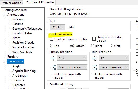

I'm currently working on drawings that require dual dimensioning by the customer. The formats for metric and imperial unit dimensioning and tolerancing are different (i.e., leading zeros vs. trailing zeroes, unequally disposed tolerance). Is there a way I can set up the dual dimensioning such that the correct format for each is followed?
John Acosta, GDTP Senior Level
Within SW, (open dwg) go to Tools/Options/Document Properties/Dimensions you can change Dual Dimensions settings.

What I'm trying to do is set it up so that the metric dimensions have leading zeroes and no trialing zeroes and then the inch dimensions have trailing zeroes and no leading zeroes. So far I've only been able to make them both the same.
Here is my setup. If you want trailing zeros, change dec places. In my case .025 would be .0250. If it's .0251, no trailing zero.

Oh Jeez! There where it says "leading zeroes", mine is set to "show" thus ignoring the requirements of the standard. Thanks Chris.
