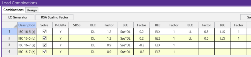

If you use RISA's load combo generator, and tell it to include Ev, it will add Ev to the 1.2 DL LC's, and will subtract Ev from the 0.9 DL LC's:
