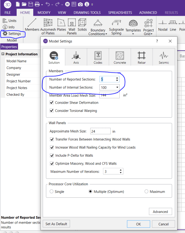

I'm modeling a continuous beam that has 5 spans and the end spans are cantilevers. When all of the spans are equal, the moment at the first supports from the ends from Risa are correct. That is they match the moments calculated using structural analysis; w(l^2)/2.
When the end spans don't equal the interior spans, the negative moment reported by Risa isn't correct. Can anyone tell me why?

So, when you go to the Model Settings in RISA (previously known as Global Parameters) there is a setting for Number of Reported Sections and Number of Internal Sections:
The number of reported sections dictates what's reported on the output spreadsheets. The number of internal sections is the approximate number of places where RISA will calculate internal forces, shears, moments, deflections. The number of places along the beam where RISA will do a code check.
In RISA when you have a multi-span physical member you might want to consider one of the following to get more accurate member force diagrams (and code checks!).
a) Increase the number of internal sections.
b) Break the member up into multiple pieces instead of using a single physical member.
I'm a huge supporter of modeling using Josh's point b)
And it really adds minor additional work during modelling. Still need to have all of the same number of nodes, just a couple extra clicks. At this stage you could break your member at the support node.

All the calculations and forces are correct. The issue is that the Member results reporting is only done at equally spaced sections (based on those two settings shown in my first post). So, the member force diagrams may miss the support location. Which is why breaking the long member into individual beams for each span is often the best solution.

Thanks Josh, that did the trick.
