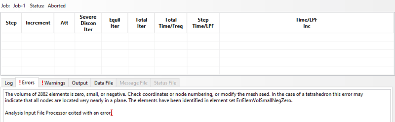

Hi everyone,

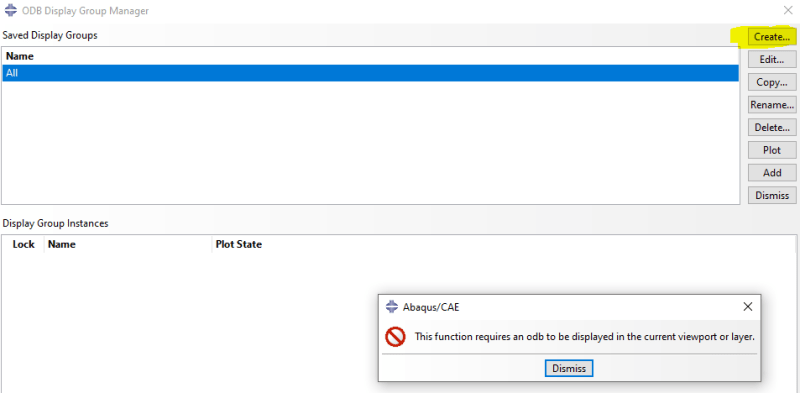

Does anyone know how to retrieve the element sets identified by Abaqus when no ODB file is made by the software? I am trying to perform an analysis, but it gets aborted before the software creates a result file. Therefore, I cannot create a display group to see the identified problematic elements.
#Abaqus
#WarnNodeAdjust
#WarnNodeMissMasterIntersect
#ErrElemVolSmallNegZero
Try running datacheck analysis. This error is often caused by too large adjustments within tie constraints.
Thanks FEA way for the response. I am still curious to see the exact location of the problematic elements, however, cannot find the mentioned element sets since the ODB file has not been created so that I could look into the display groups in the visualization module. Any comments on this would be highly appreciated.
Did you try with datacheck run ? Is the .odb file created then ? It should appear in the current work directory.
