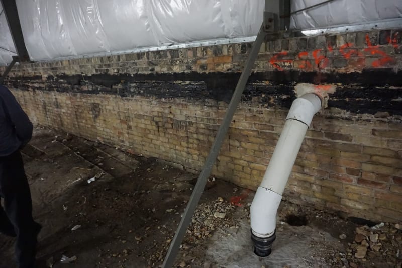

A PEMB was added to the top floor (to make it a 6 storey building) several years back. The exterior columns are supported on the original building brick parapet which is about 4’ high and 24” wide. The horizontal thrust is accommodated by diagonal angle struts fastened to the existing roof and the base of the exterior columns. I looked at replacing the struts by reinforcing the structure to behave like a continuous simple steel structure and found the framing members to be a little ‘light’. I calculated the capacity using a design dead load equal to 13psf; the original supplier may have used 10psf; I don’t know, but I expect that sort of design for PEMBs.

I don't like the sound of a 4' high brick parapet supporting the frame thrust. How does that work?
I wasn't keen about it either, Hokie, but it's been in place for over a decade. The horizontal thrust is resisted by a diagonal anble braced to the existing concrete roof. No signs of distress or cracking, and I looked real close. The load is relatively small and the brick can easily accomodate the load.

I thought you were proposing to remove the diagonal braces. But don't you have wind uplift to consider as well? The diagonal won't help much with that.
Why not just remove the whole thing, and make the roof structure a rebuild? Probably more economical. All that site welding will cost.
Yes it it Hokie. The project owner originally wanted to eliminate the diagonal struts. I went through the numbers and to 'relax' the end column to make it no longer a rigid fram using actual dead loads, I couldn't get it to work without generally reinforcing all the roof beam structure. I didn't look at the CFS roof purlins because it was too onorous to reinforce all. Lateral loading would be undertaken by discreet X-bracing. Support on the parapet was iffy, but calculations showed it was easily capable of taking the vertical loads and it was in excellent condition, being a century old. I was just checking it for existing dead and live loads.
