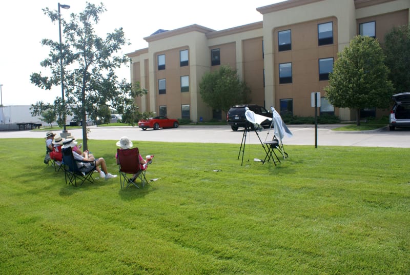

I've swam in that pool. We stayed at that Hampton Inn in August 2017 when we were there to observe the total solar eclipse. We picked York, Nebraska because it was virtually on the center-line of the path of totality.
Here's a picture showing our set-up next to the hotel prior to the start of the event:
August 2017 (Sony A100)
