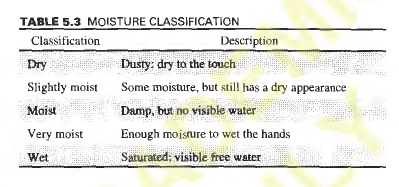

Dears
Please specify the typical ranges of natural moisture content of soil types with the division from dry to moist to wet to saturated.
Please specify the reference standard/handbook or link.

Terzaghi says moisture is described as below
2022-09-22_17_04_07-Textbook_Terzaghi_Peck_Soil_Mechanics_in_Engineering_Practice_1948.pdf_-_Adobe_A_o3sqoi.png
Coduto says moisture is described as per below
2022-09-22_17_03_59-Textbook_Coduto_Geotechnical_Engineering_Principles_n_Practices_1999.pdf_-_Adobe_b0hgho.png
ASTM says
2022-09-22_17_03_39-ASTM_D2488-17_Soil_Description_Visual_Manual.pdf_-_Adobe_Acrobat_Reader_DC_32-b_b4msfi.png
So if your looking for a consistent descriptor and typical range good luck
In New Zealand there are soils with natural moisture contents of 200% but high shear strength and stiffness, but if you oven dry them they completely lose the ability to hold a moisture content over 30-40% (and also cannot be re-compacted to as high of a shear strength as if you just left it at 200% and did best effort compaction).
It depends! You need a Geotech who has expertise in your local area and soils to have a chance of being approximately right about the answer to this question.
