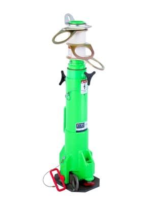

I am looking into a fall arrest anchor design and I could not find any documents speaking to load cases for fall arrest. Lets say under 1.0DL + 1.5 LL + 0.4 WL a roof truss is at 95% utilization. Given the additional 5000lbs arrest load added to the load case the truss would be overstressed and fail. Now the chances of a full live load, dead load and partial wind load being perfectly timed with a fall is extremely unlikely. Does anyone have any documents or experience with what load cases should be used for an existing building?

All that said even with those cavets I still found myself designing crazy strong mountings for this device:

So the only source for the 5,000 lb load is OSHA. And OSHA does not define whether this is meant to be an ultimate load or a service load. It only says "capable of supporting." To me, this sounds like an upper limit. It doesn't need to be "capable of supporting 5,000lbs with a safety factor of at least two"...it just says capable of 5,000lbs. So if you're using 5,000lbs, it should be an ultimate load. If it fails at 5,001lbs...that's okay. Because it was capable of supporting 5,000lbs. It's also worth noting that this is only the anchorage - you can conservatively argue that this load should be carried through the entire load path, but I don't think it needs to be. Just like impact vibrations aren't chased further than the girder supporting the impacted joist and blast load anchorage forces aren't typically chased through the whole load path, there's no need to do it here. Make sure your anchor is attached with a connection that meets the 5,000lb (ultimate) load and then follow a more reasonable load through the rest of the load path.
That more reasonable load comes from the IBC (and also meets the requirements of OSHA for design by a qualified person). If you look at the maximum allowable arresting force - 1,800lbs - that's the peak load experienced by a worker falling 6 feet or less. If there is tension greater than that, your system has already "failed" (1,800lbs is 5.8x the weight of a combined weight of worker and tools of 310lbs). So IBC says you have to design for at least 2x the maximum tensile force in the system: 3,600lbs. That's effectively a "service" load. Of course, this actually gives you a safety factor greater than two as it doesn't consider material safety factors used for development of allowable stresses or the combined effect of load and resistance factors in arriving at an effective safety factor. But it's quick and easy and conservative.
So, for a fall arrest anchor that a worker is tied to directly, I say design the connection for 5,000lbs (ultimate) to satisfy OSHA, and then design the structural response for at least 3,600lbs (service) to satisfy the IBC and OSHA. Increase if designed for multiple workers.
If you are looking at a horizontal lifeline, it's a totally different story - those loads can get extreme fast, and you really have to consider energy absorption devices and their ability to cut peak loads to the anchorage to have a change at making it work. I've considered energy absorption and deflection of the lifeline itself before to keep the numbers manageable.
For a Canadian location I would review CSA Z259.16 "Design of Active Fall Protection Systems".
In particular Section 6.2 and Annex A.4 discuss factored loads and how the philosophy for load factors and combinations for fall arrest differs from that of NBCC.
I would also reconsider the 5,000 lb load you reference. It is acceptable to use 2 times MAF as your anchor load, which is typically 2 * 8 kN = 16 kN (3,600 lbs). The obvious exception is an HLL, but that's a whole other design discussion.
