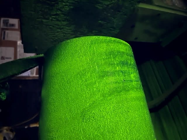

I'm investigating root cause for Fluorescent Magnetic Particle Inspection (MPI) rejections in 4340 Alloy Steel forgings.
The indication are linear that's why they are rejectable. There are no segregations, cracks or non-metalic inclusions in tested material. The microstructure is normal.
Some parts don't have any indications some parts have them sporadically in various places in various sizes. All linear indications are oriented in direction of grain flow. It is puzzling.
One of the rejected regions have been excised from the forging and aggressively etched. After etching you can see ridges (raised streaks) appear on the surface. The questionable areas apparently etched at slower rate comparing to surrounding areas. Part is approx. 12" dia machined tube. 1/4 wall. The whole part is about 40" long.
See attached photo of 2 different parts, one showing MPI indications (streaks), second showing parts section after etching showing ridges (raised streaks).
Please help explain where the streaks come from.
Is it non-homogenous material? (Vacuum arc re-melt)
Is it the forging process that creates those phenomena?
Is it something else?

Has the material been Q&T?
RE: Non-relevant (MPI) indications, 4340 Steel alloy, Forged, H/T to 170ksi (38HRC)
What's Q&T?
Yes. The material has been quenched and tempered to 38 HRC.

We didn't see MPI indications in additional inspection, after forging and prior to H/T. We see MPI indications after H/T. We can't identify any variables in H/T process.
Could it be a local microstructure difference because of some surface contamination in HT?
How much material do you have to remove for these to go away?
Parts were clean going to H/T. MPI is done after H/T and machining off 0.125 inch. It doesn't go away, after removing 0.040. or even more.
Some parts don't have significant streaks. some have a couple. some have many in various places. It is puzzling. What is it? Why it reacts to etching different that surrounding material?
Could be delta ferrite. How are you magnetizing? Do you perform a full demag before hand?
You may need to section through one of the indications to check for evidence of quench cracks. Also, how was the 0.125 removed, by grinding or turning? You may also want to check your dies for evidence of marks that could be transferred to the part.

We are de-magnetizing prior to MPI. We magnetize using central conductor (head shots). We MPI to Boeing spec. HP6-5.
How do we tell if it is in fact delta ferrite? How to rest for it?
What are causes for delta ferrite?

We did section a couple of these and we see no cracks, no segregation, no non-metalic inclusions, and the microstructure looks normal. WE are turning the parts. We are using state of the art carbide inserts made by Sandvik.
Have you tried re-heat treating any of these?
Do you normalize before hardening?
And perhaps a double temper.
I am leaning more toward a chemical segregation issue.

How can we proof that this is a chemical segregation issue? Material supplier and another lab tested samples and reported normal microstructure.
That would take some SEM work (BSE with element mapping).
Not too difficult

We questioned the MPI method first. We lowered the amperage to achieve the lowest Gauss reading permitted by the spec. The indications do come back each time. they come back after we de-mag and re-mag.
They also come back after we remove 1mm (.039 inch) of stock, by turning. We had level 3 NDT technicians and Metallurgist look at those. NDT can't accept the parts. Metallurgists say there is nothing wrong with material.
What is it? Why etching reveals ridges?
Boeing will not accept parts, that did not pass MPI, and not knowing what that indication is. This maybe an "irrelevant MPI indication" but how to explain it? Many years, hundreds of parts, we did not see them, now more and more parts have them. 10% of part and increasing...

No crack, no change in microstructure, no chemical segregation issue.
Honestly, if you have a technical contact at Boeing ask them to look over the package.
This can't be the first time that they have seen this.
And there is certainly nothing wrong with the material.

If this was Delta Ferrite, as someone suggested, we should see it in the metallurgical report, correct?
Yes, residual delta ferrite would have been plain in the SEM work.

The chemistry, grain size, and hardness is uniform.
The only thing that I can think of is that somehow (maybe during a forge re-heat) areas got to hot and almost melted.
As they resolidified from a slushy state they developed a preferred grain texture.
This is why you can look at polished and etched samples under a microscope, different grain orientations etch at different rates.

Could this be "permeability variation" due to "Chemical banding", "chemical segregation"?
I understand that that the Met report doesn't show any problem.
"The only thing that I can think of is that somehow (maybe during a forge re-heat) areas got to hot and almost melted.
As they resolidified from a slushy state they developed a preferred grain texture."
How can we detect this "preferred grain texture"?
Your reports don't show any chemical issues, so preferential orientation does become a suspect.
This can be checked with XRD or some specialized SEM methods.
I have never done it on an SEM but I have seen the figures generated.
You are measuring the orientation of each grain

I am sure that you know but this could matter because magnetization is highly orientation dependent.

The MPI indications appear only on some parts in the same H/T lot and material heat lot. That's why it is so puzzling. We can't find any correlation between defected serial numbers and any process parameters.
The indications look like subsurface indications. That is why they are rejectable at MPI. After re-machining (skim cut) the indications are still there.
We are thinking Alloy segregation may be the cause.
Another photo of MPI indications.
