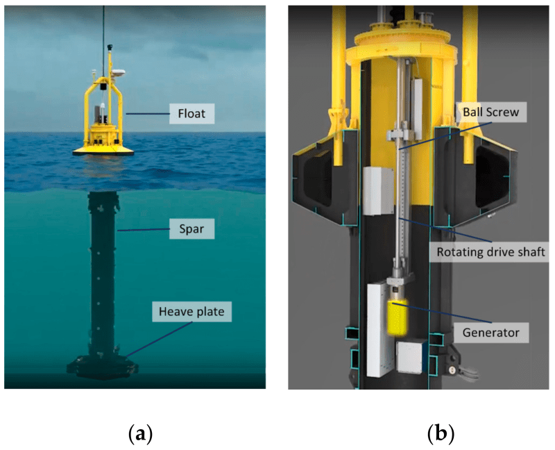

Another possible source of 'clean' power... don't know if it works or what the 'cradle to grave' footprint is, but if something like it can be used, it may help... [ponder]
Aren't waves wind powered? Why add a middleman?

Super... The methodology or due to wave action close to shore?
I'd say the size might be the biggest (see what I did there?) thing. Scaling it up to something useful would take a massive surface area.
It always seemed to me that the simple vertical bobbing buoy type system would be the most feasible with an array spread out over an area similar to how wind farms are, but my knowledge in this arena is also very limited.
- Andrew
Methodology. The more power they try to draw the more rigid the device will become. With any kind of load on it the device will behave like a board floating in the water. We all know that board doesn't heat up getting tossed around in the waves so there can't be any energy being absorbed.

Maybe there's a balance, Tug? If there is a mass, moving up and down over time, there's power of some sort... maybe a matter or harnessing this? That's what made me think that there could be merit, but as Super... noted... not in my realm, either.
Yes, there is a balance and it's tipped in the wrong direction. These types of oscillating devices don't work because of a very simple equation, work = force × distance. If you increase the load on the system force goes up and distance goes down. The force and distance balance each other out and there is no work done.
Of course there is some work being done ... but extracting that is difficult and creating a design to tolerate the extreme waves also difficult.
Ocean Power Technologies is the simplest one, like I was talking about with a vertical buoy, I know of since there's no hydraulics and it is a fairly self contained unit. The company still isn't ready for primetime (ie. not successfully deploying units), but I think the premise of their "Powerbouy" makes sense at least.
- Andrew
Do the math. The heaviest navigation buoys weigh 10 tons, this looks to be a bit smaller but we'll give the benefit of the doubt.
(20,000 lbs × 3ft up) + (20,000 lbs × 3 feet down) = 120,000 ft*lbs of work done and this is REALLY generous as the buoy will be buoyant on the way down and the generator won't be generating electricity at the top and bottom when the buoy moving slowly. Also, the average strong swell is around 6 feet but the buoy has inertia and doesn't follow the full height of the swell (even without load) which is why I chose 3.
120,000 ft×lbs at let's say 6 times per minute for an average swell period is 720,000 ft×lbs/min or 21 horsepower.
In electrical terms that's 15kW. That's a really bad number and I made all of my assumptions in favor of a higher output and did not consider efficiency at all.
This is a scam just like the gravity battery.
There is a reason these systems use lots of mechanical parts such as ball screws and gears over strictly electrical means of generation, it's to create the appearance of work for the investors.
