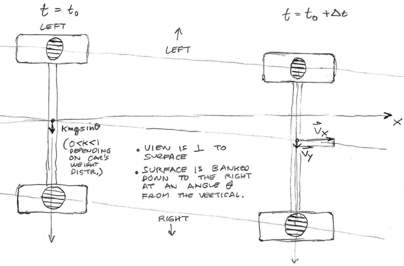

Greetings,
Interesting question: if we have a solid axle of a vehicle traveling in a straight line path, do the two tire velocity vectors always need to be parallel, i.e., do the tires have to have the same slip angle? (I'm imagining a vehicle traveling along a banked section of pavement, for instance, where the loading on the wheels won't be equal.)
Thanks in advance.
Thank you, Greg.
Then extending the question just a bit, if we have this straight-traveling solid axle where I will presume that all compliance resides only in the tires, then for a hypothetical car traveling along a flat surface banked left or right, and with a positive COG height, then with the lower tire having greater loading then the higher one, this lower tire will experience larger slip than the higher one. And if so, then the tires are toed-out according to their differing velocity vector orientations. Correct? (I'd rather bypass camber until I get past this simpler question.)
Start with a skateboard car, no kinematics or compliances. The forward velocity at the outer tire patch is greater, due to R, the lateral velocity is the same for each, steady state. For the tire if there are no toe effects and no yaw then the slipangle of the outer tire (atan(vy/vx))is less than that of the inner.
Cheers
Greg Locock
Thanks again. I think you're saying we get toe-in rather than toe-out. To make sure I communicated my second question clearly, please look at the diagram above. (For the time being, I'm only suggesting tire velocity vectors.) Was this your understanding as well? Vx and Vy are for the entire axle and not the tires, incidentally. Also, assume neutral steer so the path has no curvature.

Hi Cibachrome - All of that makes sense. My hypothetical axle is in static equilibrium after the steady state is attained, so the external moments and forces must sum to zero. The initiation of the transient state as I've described it could be created by having the vehicle's COM height go from zero to whatever might be its nominal value for t > t naught.
Some assumptions about this axle: No differential. No roll steer. No assumptions whatsoever about its suspension aside from ensuring the conditions shown in my sketch are met. Identical tires left and right. So, this axle doesn't exist in real life, just as massless rods with infinite rigidity, which are cited everywhere in physics discourses, don't exist either. Even so, I think considering what happens to this axle has valid real-world implications.
Here's my understanding of what's going on here:
We know for t> t naught that the forces and the moments change. The lower tire becomes more heavily loaded than the higher one. The lateral force from the lower tire is greater than from the higher tire. Without considering pneumatic trail for the time being, the slip angle for the lower tire *must* be (please correct me if I'm wrong) greater than for the higher tire.
We know this divergence in slip (and therefore tire contact patch velocities) can't continue indefinitely, or the axle will separate, or the higher tire will start to slide.
So at some time after t = t naught, static equilibrium is attained, the tire velocities restore to parallelism (probably exponentially over time), and the slip angles become equal. Regarding pneumatic trails, we assign to our imaginary suspension the additional task of creating an equal and opposite Mz to maintain zero yaw acceleration.
So in summary, the tire slip angles go from initial divergence (toe-out) in the transient state to parallelism (zero toe) in the steady state. Looking at Fy for each tire contact patch, the equalizing factor arises from tire deformation. It's simply an inevitable consequence of the differing tire velocities. As the initial paths diverge and the tire deformations grow, the deformations create equal and opposite internal forces (for the axle, that is,) that likewise grow, until the sum of the internal and external forces acting on each contact patch equalizes. When this sum equalizes, the slip angles become the same for both tires and the pneumatic trails become equal.

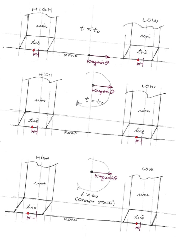

So there are three things influencing tire shape happening here. The first is the axle overturning Mx moment as you call it, which somewhat compresses the lower tire's sidewall and slightly extends the higher tire's sidewall. Then we have the kmgsin(theta) force exerted on the axle arising from the rear axle's burden of the vehicle's weight, creating negative camber for the higher tire and positive camber for the lower tire. And then finally we have this changing camber in the transient state arising from the divergent velocities causing the contact patches to spread a bit farther apart from each other. This camber contribution is negative for both tires.
On edit, here's a schematic sketch of what I believe is happening as time passes:
