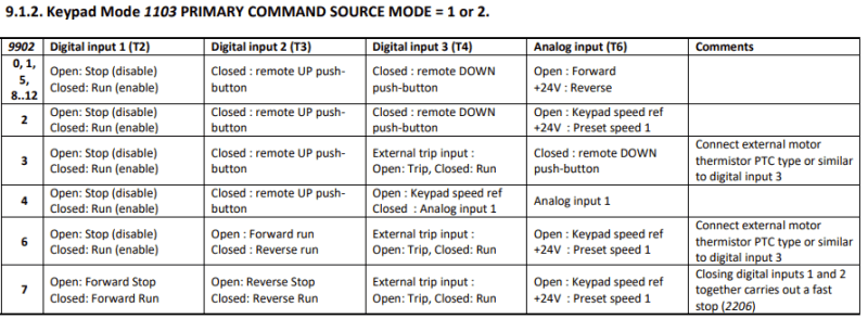

Based on the manual, we have set the ACS255 to the following operating parameters:
Parameter 9902 is set to 0
Parameter 1103 is set to 1
These settings essentially should allow us to operate the VFD while the DI2 is closed (Run enabled). See image.
This is an out of the box VFD.
We tried manually spinning the shaft while connected to the pump and it didn't turn either, so we are waiting on a new pump because the one currently installed seems to have its bearing damaged. This seems to be the root cause of the problem.
