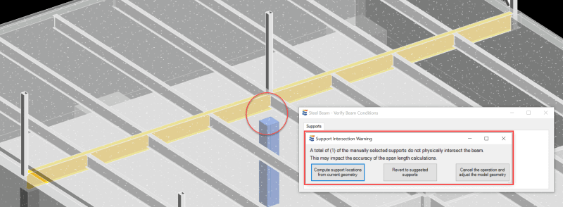

Most excellent. That should make life easy. I guess the only sticking point will be ensuring the physical model is actually modelled correctly (beams connected to beams, etc). In a perfect world it would be, of course. But unless the engineer is doing the modelling themselves it might be a little hit and miss since drafters might not be spending the time to ensure connectivity. Is some sort of tolerance built in to the program when determining connectivity? E.g., "beam endpoint is within 0.5 inches of girder centerline" and detects/connects it?

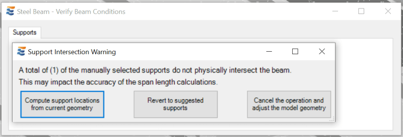

Concerning modeling accuracy, you'll find that there's a lot of flexibility and intelligence built into EFR's process for interpreting model geometry. In addition to proximity tolerances, you also have the option in extreme cases to instruct EFR to compute extrapolated connection points on the fly even when elements don't intersect at all. Here's an example of what that might look like:

@SRoswurm
Re: modeling accuracy: that's another plus in my book!
