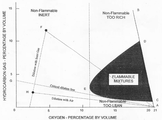

One of the references I ran down talked about floating roof tanks with geodesic dome roofs, to either keep rain off of the floating roof, or to aid in vapor recovery. The tanks at issue in the Cuba tank farm fire had domes installed, so regardless of the presence or absence of floating roof, the headspace is a risk factor.
If the space above the floating roof (or oil surface) and the dome is not kept out of the combustible / explosive region, we have one side of the boom triangle.
