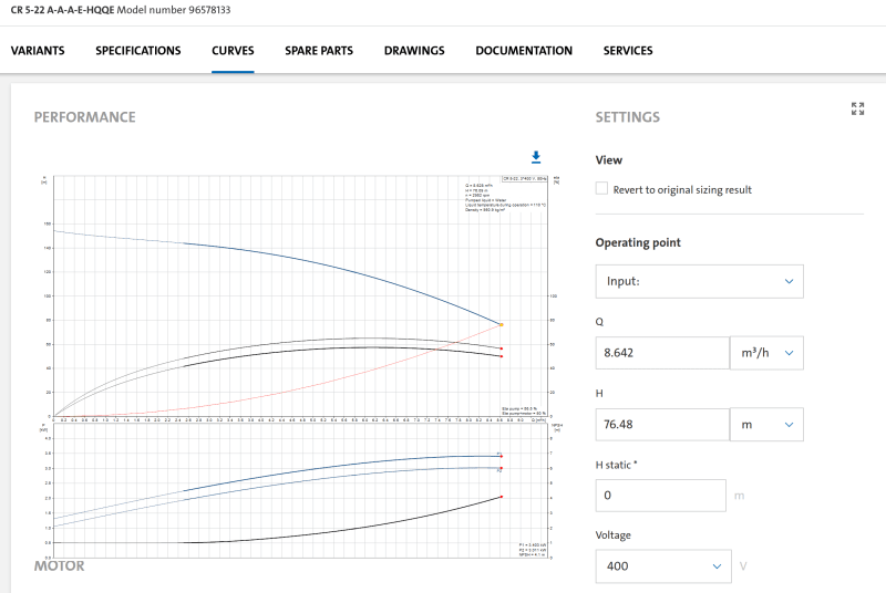

With regards to NPSHa, at the following conditions:
Head in: -7m
Pressure in supply tank: 0.5 barg
Water temperature: 110 C
Head loss: neglect
NPSHa = 8.43m
NPSHr (@ 8m3/h) = 3.5m (see image)
So, yes, the most obvious solution is to add a preheater HX and then control the recirc flow via the mixed temperature. But... I still have not heard anyone comment on the subject of the equalzing vents. Anyone?

I can see how water downflow traffic drops down through the stripper, but it is not clear how vapor from the bottom rises up through the trays. Vapor upward flow seems to be blocked by the curtain of water going down as it trickles over the chimney hat above each tray. So I cannot ( at the moment) comment on these mysterious vent pipes on each tray. Btw, these vent pipes are not shown on the first of the internal drawings you've posted.
The recirc pump flow curve you've attached says H=76.5m head at approx 8m3/hr. But your actual required delivery head couldnt be more than 10-15m at most, so is there some flow control valve on the recirc pump discharge burning off some 60-65m of head? NPSHa as you've reported seems to be more than adequate, but I would take a closer look.
