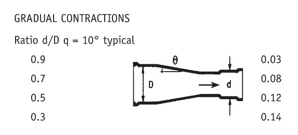

What is the Hazen Williams minor loss k-factor for a 4" X 2" DI flanged reducer? Thank you for the help!
does this help?
