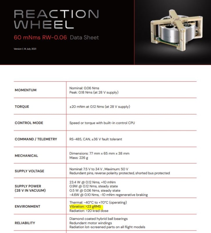

Hi, just to check the Grms for electronic equipment. Why is it smaller component (30gram) can take up to 15Grms,heavier component (400 gram) can only take 8Grms?
It could be to drive the structure to "sensible" sizing. The smaller payload at 8g is only 0.6N and about 1.2N at 15g ... both pretty "silly" (small) forces.

Grms is G root-mean-square to determine the vibration energy. I attached one of the subsystem, reaction wheel. It is around 250 gram and 23 grms.
I do notice from another company selling reaction wheel 400 gram but 8 grms and a sensor as light as 30 gram with higher vibration energy. Does it mean for heavier component, we try to keep the vibration energy as low?

higher mass and lower vibration loads ... makes intuitive sense. A higher mass at the same vibration load would have larger forces than a smaller mass.
It's not necessarily an apples to apples comparison, even if they ostensibly have the same function. Something with 10x the mass would be applicable for platform with possibly 10x the mass, so environment can't necessarily be the same. The launch environment would potentially get dampened by the extra mass of the host platform and its launch installation hardware, for example. An ESPA ring has a lot of mass by itself, so it can't transmit as much environment to a SmallSat attached to it, while something like a Starlink satellite is much smaller and has a very different, and its equivalent of an ESPA ring is possibly much lighter.

I just found another brand of reaction wheel that weight 215g with only 8.9g RMS which is much smaller than the one weight 226g reaction wheel with 23g RMS.

I think you are seriously confused. The objective is to find components that can withstand THE environment, but not overly so as those will tend to be more expensive. You seem to be thinking that matching specs is a thing that you should be doing, and it's not.
You need to start over and identify the overarching environmental requirement, which is often only the launch environment and select components that can meet those requirements with margin. The more critical spec for optical payloads is to ensure that the reaction wheels don't generate so much vibration that it degrades the image quality of the sensor. THAT is often a harder nut to even properly identify and model.

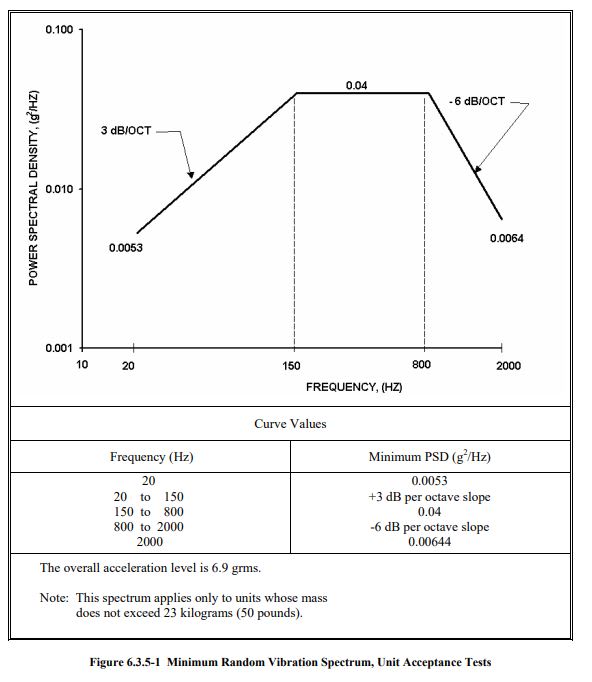

We are first time developing optical payload. Based on the launcher environment, the g RMS is pretty high at the optical payload mounting. So, I take a look in other subsystem to see if it is reasonable.

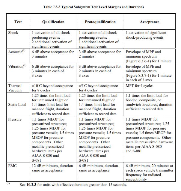

I have another question.. is the random vibration table given in the launcher vibration environment(for example Figure 6.3.5-1 from SMC-S-016 below)meant for Qualification level?
Typical unit test level and duration in the launcher also similar to Table 6-3-3 below.
it sounds like the launcher is applying a high vibration load to your payload, and yes your structure needs to support it.
yes, it sounds like your tests should follow those requirements. Hard to read your table, too low resolution (blurs under zoom).
are you saying that your payload had 20g response to this spectrum ? ... doesn't sounds good.
Sounds like you are still confused; if your test environment is 6.9 grms and your payload response is 20 g, then you have a poor design that is resonating crazily, and needs to be redesigned, FULL STOP.
What you are looking at in the spec sheets for reaction wheels is irrelevant to your payload design; those are the environments those components were designed to withstand and perform to spec afterwards, and had only marginal connection to your design, for which you already have a spec and it looks like you didn't design it to survive the spec.
Now, it's hypothetically possible that you can get away with leaving the design alone and so long as your optical payload can survive the load, that's OK, but the resonance, or excessive response, might likely couple into other components and damage them.
TTFN (ta ta for now)
Nah, whilst the structure may survive the loads manifested by the vibration, the structure is needlessly heavy ... a critical flaw in spacecraft design.
yeah but his payload is 15kg getting excited up to 20g for an applied acceleration of 0.04g, AIUI.
