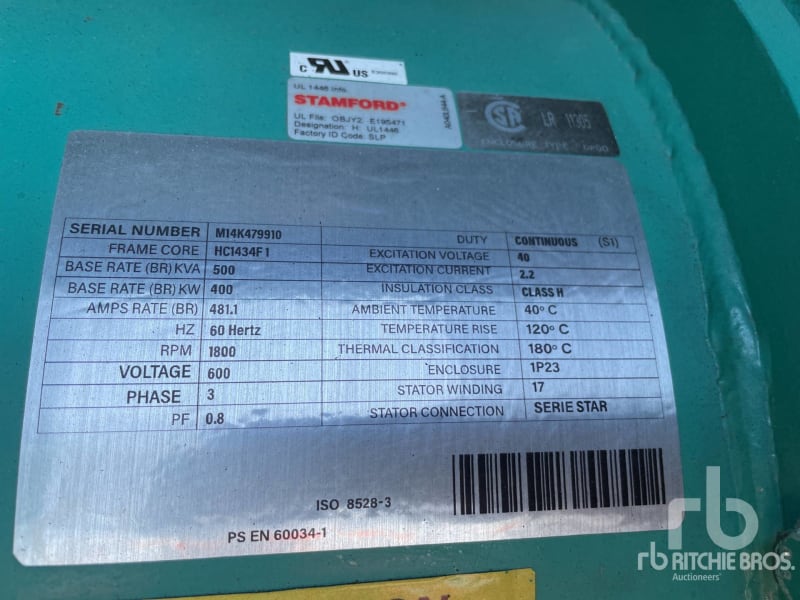

Hi All
I'm looking to possilby purchase a cumming generator in auction. It has a stamford 600v alternator.
I need 3 phase 480/277v. I'm been told that its not a huge deal to get these re-strapped to run 480v.
Picture below of alternator. I also found a link tot he stamford sheet on winding and voltages which is below (this state is wired as '17' configuration.
Can anyone tell me A if possible to convert this and B what it entails and the approximate costs involved in doing so?
Just trying to make sure its doable before laying out any cash
thanks in advance
Yes, you can rewind the stator to 480 V, 60 Hz. No need to touch any rotor or exciter windings. Stator rewinding cost will depend on your location.
If you plan to run the alternator at 50 Hz (IEC world), the output voltage will be 500 V without any rewinding and output KVA will be 5/6 of 500 KVA. You can get away without any rewinding by setting AVR to 480 V, 50 Hz.

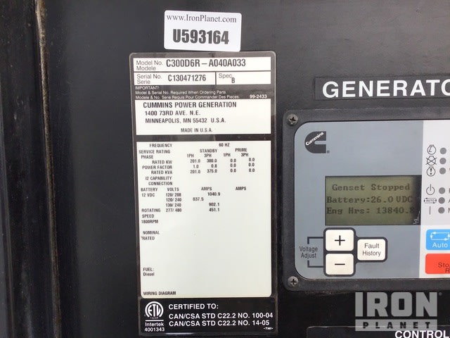

I must be losing my mind- looks to me like the alternator is rated for 600V, 400kW but is actually used at lower voltages.
The rating sticker lists 300kW at 277/480 as one of several possible voltages. If I was buying it, I would figure on a good chance of
it already being set up for 277/480 or at most a rewire and regulator adjustment.
If you can, start it up and see what the metering indicates.

The nameplate on the generator is the one that counts. The other one is a generic sticker done by the genset assembler where they probably mean you could preorder the genny in those ratings from the factory. I doubt you can rejig from 600 V to 480 V just by rewiring.

The rating sticker could be inaccurate- it clearly says "battery 12 VDC", while the display says "26 V" (indicating a 24 VDC battery) and does not indicate 600 V at all.
Again, I must be losing my mind- I do not see why the 600 V, 500kVA, 60Hz rated generator will not produce 480 V, 375 kVA, 60 Hz if the voltage regulator will allow a lower setting.
If need 60Hz output must drive it at 1800rpm, so can't reduce voltage by speed.
Need to check output voltage vs excitation field reduction and need to care about output power (not as voltage reduction only /as math equation but as field reduction effect).
Below some field point genset may became instable as controller / AVR parmeter tunning and as eratic/non-constant output voltage.
This voltage reduction request AVR modification in output voltage sensing and possible in PID parameters.
What is somewhat strange is so low field power - 88W - for such output power... about 1:4500 ratio.
wayne
AC Generators and induction motors are constant flux machines operating near the knee point of the magnetization curve which means constant V/Hz. 480 V/60 Hz is 80% of original 600 V/60 Hz. This leads to much reduced flux density well below the knee point, which results in voltage instability. Every load change will see drastic change in generator voltage with such 480 V voltage reduction at 60 Hz.
If you run the same generator at 1500 RPM, 50 Hz, then V/Hz (480 V/50 Hz) is reduced only by 4%, which you can likely get away with by manipulating the AVR setting for 480 V. At 50 Hz, the output will be 500 V, 500 KVA without AVR manipulation.

This generator is a rental generator, so it has a voltage selector switch that allows you to change the voltage between 208 and 480. The alternator is capable of 600V, that is why the Stamford data tag lists it. But you have to go by the generator model and serial # tag.
I looked up the BOM by serial number and confirmed the voltage range of 208-480. I work for Cummins if there are any questions.
Thanks, I was starting to wonder if I had forgotten how to read a Cummins rating decal.
