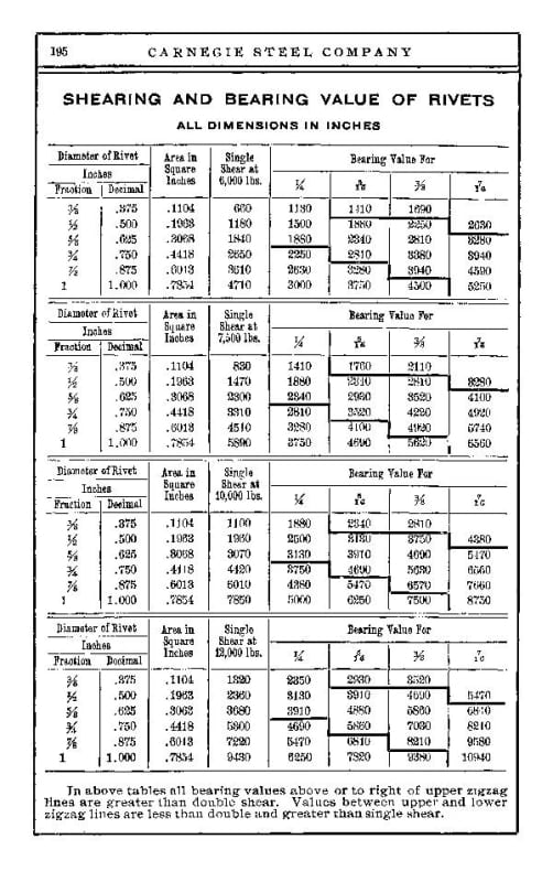

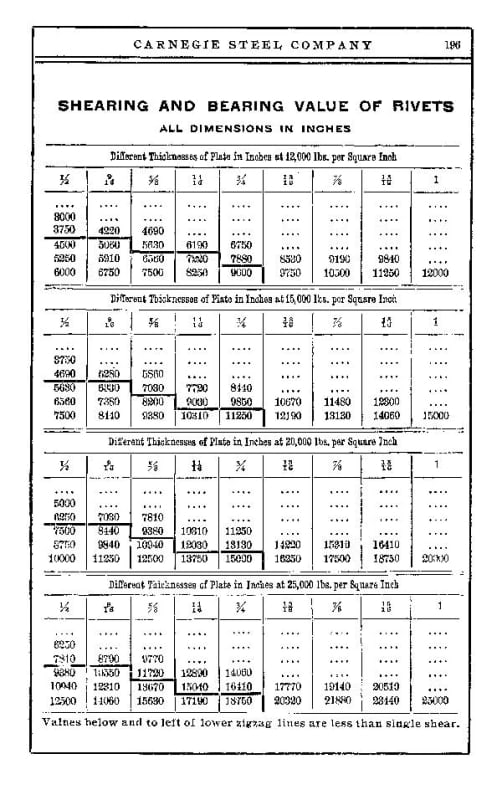

Using the tables in DG15 (specifically table 4-3b) I end up with the rivets controlling the connection significantly, before I even apply any sort of safety factor. Heck, the carbon steel bolts also in the connection I'm looking at end up beating them out, which my gut says isn't correct. Doubly so after reading about all the love for rivets people have here.
My best shot has been to treat the rivets as bolts, and working through the connection per chapter J in the steel manual. I did use DG15 table 4-1a to find the strength for A191-49T Rivets, and then utilized C-J3-3/4 to find Fnv and Fnt from the ultimate strength. I am not entirely convinced of this method since, I mean bolts aren't rivets.

I don't recall whether we ever found a researched rationale for applying the same slip and ductility characteristics for rivets as modern bolts (e.g. for the coefficients baked into the ICR analysis method), but I seem to recall we used it, had the support of our reviewers (Caltrans), and it worked in the field. A good rivet (you can tell by the sound when an ironworker first hits on it with a chisel) is generally as or more ductile than a bolt, just weaker. So yes, I agree that "modern" analysis methods and the tables from your steel manual can be used to sharpen the analysis without issue.
A well-installed rivet will provide significant clamping force (pretension) across the joint, so they often "overperform" their specified (shear) capacity. But that's not reliable enough to count on without some other evidence.
That said... rivets are simply milder steel than HSB. So yes, the connection capacity is less. Without seeing more about your specific situation, I can't speak into the disconnect you're seeing.
