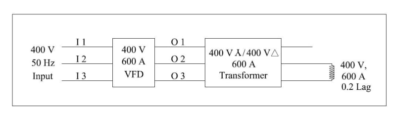

Not feeding the single phase load directly from the VFD output but via a Y/D transformer. Will that affect VFD input current balance?

Most VFDs have an input rectifier (there are some models that have DC input only, most of them in multi-axis systems).
After rectifier there is a DC bus capacitors bank that feed then 3 phase inverter.
If one phase of inverter remain unconnected and load is inductive type there is no problems with VFD input current balance.
For high inductive load and at such current will be a problem with disconnecting load (high voltage spike)... will be better to reduce voltage from VFD control and then switch off load.
The schematic for the proposed system below.
What will be the I1, I2 & I3 and O1, O2 & O3 currents for a single phase 400 V, 600 A, 0.2 PF inductive load on transformer secondary?
Muthu
I'm doubtful that will work, but a VFD is a power conversion device so input currents are always typical of a 6-pulse rectifier with levels matching that required to feed the real power used by the load.
