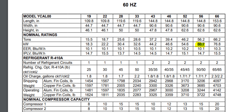

I am working on short circuit calculations for a system. There is an HVAC unit (nameplate attached). I did verify (Unit Power Supply) the cable and upstream protective device do meet the minimum circuit ampacity and max circuit breaker size, respectively. I have the following questions about the nameplate and how should it be modeled in the study software :

[li]Namepate shows TWO systems on the nameplate what does it imply? Is one backup to another? [/li]
[/ol]
Yes, there are two systems in there, each with two scroll compressors that have 55.8RLA @ 200V 3 phase and 2 fans with 7.6RLA. So a total of 4 scroll compressor and 4 fan motors.
Link to manual, go to page 82.
Thank you, @jraef. Now I understand. In the manual on page 38, I see the kW also listed (attached snapshot). Here the total kW will be 66.7kW for the whole system correct?
