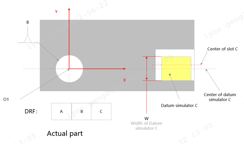

Hello,
I have a question about the DRF. How to define it for the actual part?
Is the understanding of the two DRFs on the left side of the figure below correct?
My doubts are mainly about the origin and direction of the coordinate system.
Thank you.

I think you're asking about some accidental offset -- if the slot is not directly across from the hole.
The lower picture on the right has the correct x/y coordinates for that arrangement of datum references (because the slot locates the horizontal before the hole is engaged).
But the upper picture isn't correct -- If the hole is the secondary datum feature, then you indeed have the origin of the x/y at the correct location. But since the slot only controls rotation, the two red lines would be rotated counterclockwise a little. (Or, to say it better, you can keep the red lines there, but the entire gray part would be rotated clockwise a little -- see pmarc's picture below.)
The best way to think about it is to envision a fixture (datum feature simulators) that would engage A, B, and C. The block that slides into that slot (for the upper picture) is always directly in line with the hole's axis. Even if the slot is shifted up, the simulator still slides into the slot while in line with the hole's axis.

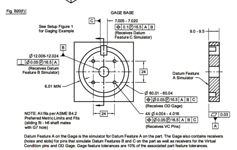

alone_dancer,
This may not be the exact scenario but it looks close to the question you're asking. This is from Section 4 of ASME Y14.5-2009 standard.

What I want to say is the determination of the actual DRF under the two DRF (ABC/ACB) annotations for the drawings on the left and the actual parts on the right.
Assuming the features A, B and C of the actual part on the right is ideal, only the center of slot C and hole B has some offset.
Belanger,
Really appreciate your detailed explanation and great advice.
I have a question about the fixture you mentioned. The fixture (datum feature simulator) will be like the yellow part shown in the figure, and 'W' (width of of Datum simulator C) is adjustable so that it aligns with the hole at the center while matching the slot. Is it correct?
Thanks for the example.
It is also what I want. I'll study it.
The yellow simulator will be adjustable in width (because there's no "M" after the datum reference in the feature control frame). But its center will need to stay in line with the datum B axis.

I think this is how the two alignments for the part in question should look like:
Got it. Many thanks.
Totally understand. Thank you very much for your detailed explanation.
So an important thing is that the position tolerance of the tertiary datum feature relative to the primary and secondary datum feature should be defined.
