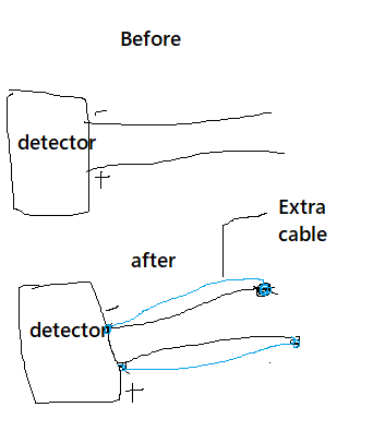

Jun 20, 2022 #1 helpyou Automotive Joined Sep 26, 2011 Messages 79 Location QA HI How I terminate two cables in parallel in the loop. The loop consists of detector in the field, junction box, marshalling cabinet, and system cabinet. Already one cable exists, i am adding a new cable to decrease voltage drop. Thank you
Sep 17, 2022 #2 K Baaru Civil/Environmental Joined Feb 12, 2022 Messages 12 Location IN Hi Helpyou, Connect as attached So that the resistance of previous black colour cable gets reduced, once the blue colour cable is connected to the respective black colour cable. Upvote 0 Downvote
