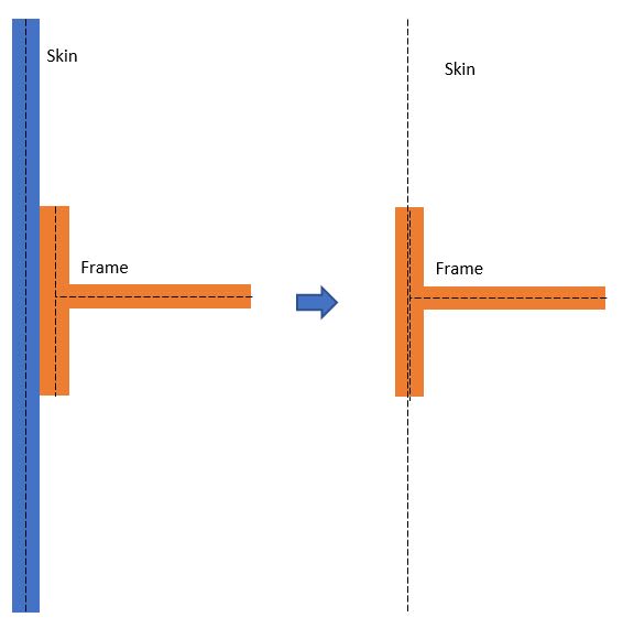

Hello, want to check in airframe assembly such as fuselage modeling, how do you handle the connection between the skin, frame or longeron? Just to merge them or using rigid element connector?
If we merge the frame to the skin, are we still model all parts as midsurface? There will be gap between parts, right?
Do not use rigid elements to connect.
Usual approach is to model skins at midplane and move the frames and stiffeners to the skin node locations.
Or use solid shell elements in Abaqus for skin.
@SWComposites, thanks!
If we plan to extract the load, RBE2 or mpc still not advisable to use to connect the frames to the skin?
Is the picture below correct?
Picture is correct.
I’ve never used glued contact. If you want to use it, build and run some simple test models to be sure it does what you expect.
Avoid rigid elements; they can create all sorts of havoc in the model.
no one (AFAIK) worries about the fuselage skin mid-plane, the impact on the section properties and the loadpaths within the structure are negligible.
you have the OML of the fuselage, use this for the skin. Sure you could model the mid-plane, but meh.
use the skin surface (nodes) as the frame outer cap and the stringer reference. You "can" model the stringers as offset from their nodes (on the property card), but this adds a lot to he model computation for little gain/difference. ie use one set of nodes for the skin, the frame outer caps, and the stringers/longeron outer caps.

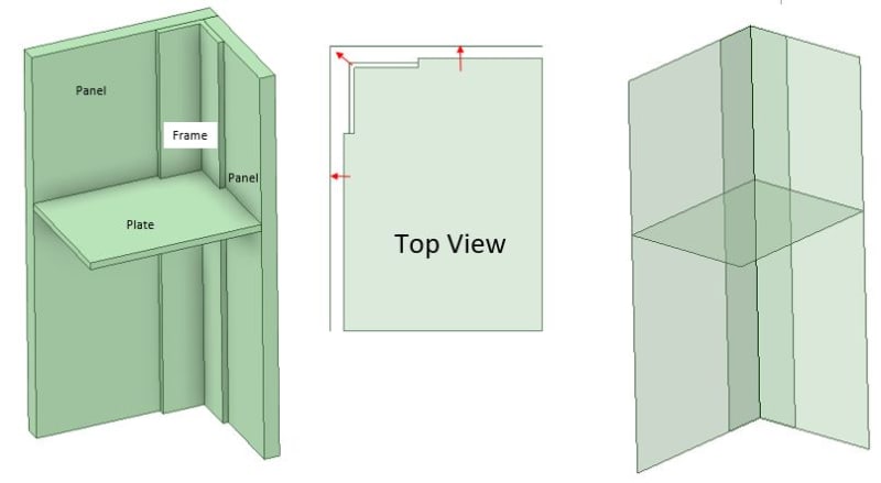

If I model all parts in midsurface, is moving the frame to the skins/ panels usual approach?
Its a typical approach for a transport fuselage.
What are you trying to model? That picture is not a fuselage.
The FEM should give you element loads. From that you create free body diagrams of the bolted joint connections and determine fastener loads and bypass loads by hand.
@SWComposites, it is equipment box. I randomly create a geometry for discussion.
