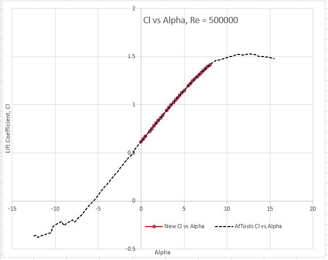

I got the selig format dat file and ran some calculations in Xfoil for Re = 500,000. I only did a AoA range of 0 to 8 degrees but it seems to match up perfectly with the data on Airfoil Tools.
So we know at least the computational methods are being consistent.
You are right that there is a bit of discrepancy in the test results (at least in the report that I linked to). But I notice the plot in the figures was made for a Re = over 3 million.
I would make sure your Reynolds numbers are consistent when comparing.

@LiftDivergence the reynolds number I'm trying is 3.47 * 106, what type of flow are u using: inviscid or viscous?
