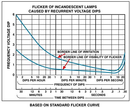

This is high frequency and different in kind from the first flickers which appear to be voltage drop issue due to high impedance / loose connection.
I have a feeling it is due to the controlled-load frequency that the supply authorty delivers in the area: this high frequency interposed over the base frequency is used to communicate with the meters for controlled load and remote reading maybe.
Any ideas?
If you can see it, it is not high frequency.
I would tell this authority what you are experiencing, and see if they'll take some readings and provide some analysis and possible correction.
@stevenal thanks for your reply, there are a lot of apartments in the same building that are not experiencing any flickering. Also these are LED lights not incandescent: the incandescents back in the day used to have 'thermal inertia' to ride through frequency canhed, for LED: it all depends on the capacitor. Say an LED is 10W, at 12V DC: this means 830 mA in total <- changes in voltage have much higher impact for LED than for incandescent. The supply authority will say it's nmot their problem as other similar apartmens have no flickering. If you have a look at the first videos in the original post, i meant to compare the frequency with those: it is 'higher' frequency :) I suspect the tone frequency on the grid is 790 Hz if that helps

To skip a step - the OP apparently lives in Australia where someone decided to use +/-6V variations in the signal to allow the power company to communicate with water heaters that evening/overnight power rates were lowered. This was a great idea maybe 50 years ago and it's cheap. What I don't understand is how long this runs for, but it would seem like only a few minutes as the randomized startup is done by the water heater receiver so it's not like they are working through the address space over hours long periods.
"In some parts of Australia power lines are injected with a ripple voltage, or pulse. This can be at a frequency ranging from 167Hz to 1050Hz and is also known as the Zellweger ripple or audio frequency injection control (AFIC).
The below image shows the impact of a 1050 Hz signal with a magnitude of approximately 6V (2.6% of 230 V) on a waveform measured in the field. " from

It appears that when the line voltage is 230V, the 6V does not make much difference, but when people start to use dimmers and reduce the voltage, the impact of the 6V becomes much more pronounced: hence they included the SDD in the PDF but the filter is actually in the light.
