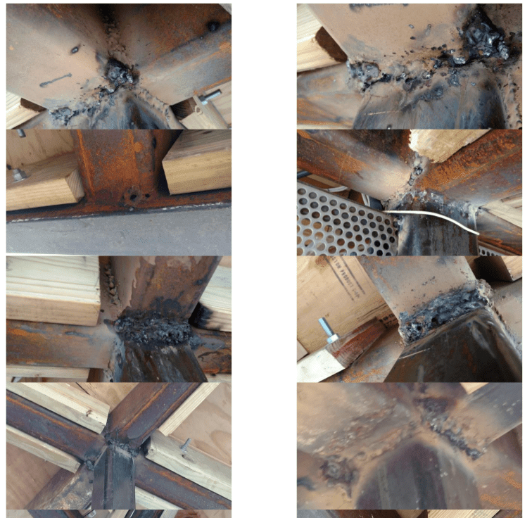

Do not put much trust and faith in welders, lot of them are meth addicts. I would definitely weld the full tube together, not just top and bottom. See image below from one of my projects:
I get it. You had a welder (or, more likely, a bad contractor's friend who picked up a welding machine at a yard sale) botch a job. But could you paint with a wider brush? Yikes.
I don't mean to push stereotypes, I've met many welders who are my friends. They openly talk about their drug use which is extraordinarily common in the industry. The point I'm trying to make is to not design welded structures at the bare minimum of what is calculated. There are always other considerations beyond the math and numbers which drive our decisions. It's always better to be proactive, especially when we are hanging truck-sized loads overhead on a 4X4 tube.
Man, those are some ugly welds... I've not seen anything like that...
bhiggins - fair enough. Glad I don't work in your area. All the welders I've known are good, hard working people with no apparent drug issues. Now they haven't all been good at their jobs, but that's another issue...
