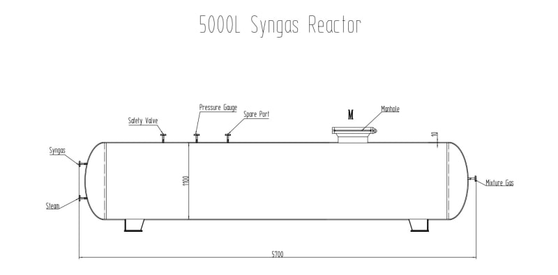

Hi. I am doing water gas shift reaction on syngas produced by pyrolysis.
I am looking for the temperature needed for such a reaction
and what kind of catalyst should be used.
The outcome desired is CO2 and hydrogen
The composition of the syngas is co, co2, h2, ch2, c2h4, c2h6, c3h5, and others

Dear georgeverghese Thanks so much for the info. I have a design for the reactor could you please tell me if it is a good design. It is horizontal not vertical to make the gases come in contact with more catalysts. Is this a good design or should we go with a vertical design
It is difficult to maintain uniform tube temp (with gas burners for temp control) in a tubular horizontal reactor in industrial large scale practice - I have come across vertical configuration only. A HTS / LTS reactor licensor designer may be able to advise for smaller scale units like this one for 5m3 only.
Dear georgeverghese
We modified the design to a vertical one with the gas inlets at the bottom making the gasses pass through the catalyst.
