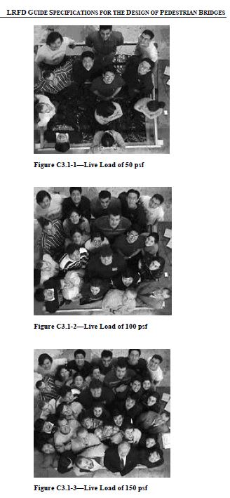

I don't even think they were at 50psf...
Noticed that... I'm happy that no one appears to have been seriously injured.
Thanks for the post Joel... it puts live loading into perspective.
I stand corrected. The remaining chains were just a makeshift railing. Still think it was a DIY job, probably by someone who didn't even know the meaning of live loading. 'It's the connections, stupid.'
Seems to me, if you aren't all that familiar with "live load" and such, you would overbuild.
