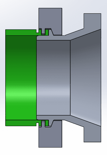

Howdy all,
I'm designing the tooling to test a pneumatic motor and I'm stumped by this connection in the pictures below. It's a 2.25" OD with two grooves. The first grove, the larger one I thought was an O-ring gland, but it's a bit narrow at .091 inch and way too deep at .125 inch. The second, smaller groove is just .050 inch wide and .080 inch deep. I designed a connection that "works" using a couple stacked O-rings (size 033) and uses the narrow slot to fit some machined L-angles with bolts to hold the attachment sleeve in place. I'm just not happy with my design and I might make a better connector if I knew how this connector is supposed to work. This is for the pneumatic actuator motor on a 747 leading edge flap drive.
Anyone familiar with the mating connector that matches this port?
Thanks,
-Kirby

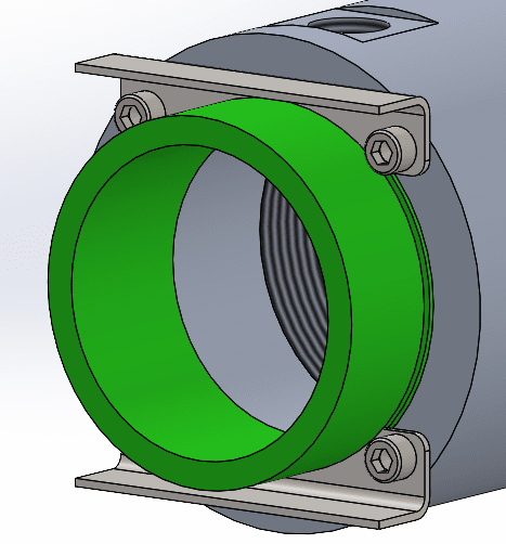

After fiddling with my parts I came up with a small modification to my design that made it workable. I originally was just going to use these bent clips to hold it in place, but after the machinist gave me the parts (and before I gave it to the tech to use) I tried installing it and there just isn't enough space to screw in the bolts. (green part is a model of the connector.) I slotted two of the holes so I could have the fasteners already installed and then just pivot the brackets into the slot and give the fasteners a quarter turn and it should work.
I think if I was going to do this again I would fab the mating part to receive a flat 'U' shaped bracket that goes in the narrow slot like Compositepro was thinking of.

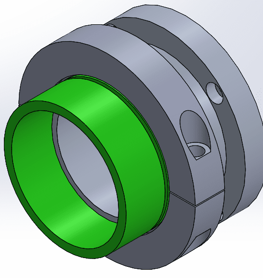

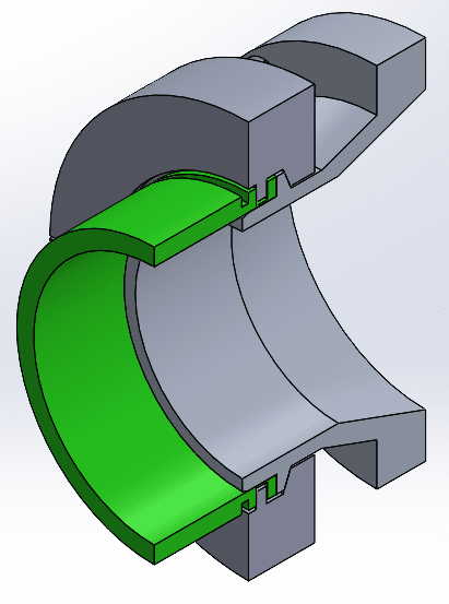

Thanks for the sketch moa1. Someone found a mating part that was used for testing on a different stand and it looks like half a V-band clamp that presses against the face with a couple of blocks that clamp around giving a tight fit in the larger slot. See the pictures. This seems like a much better design then what I had. Here's what I came up with.
